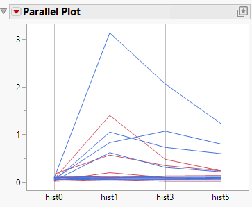

Create the parallel plot:
5. Select Graph > Parallel Plot.
6. Select hist0, hist1, hist3, and hist5 and click Y, Response.
7. Select the Scale Uniformly check box.
8. Click OK.
The report window appears.
Figure 7.2 Parallel Plot of Histamine Variables
Each connected line segment represents a single observation. Click a line segment to see which observation (or row) it corresponds to in the data table.

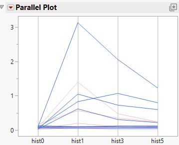

For further exploration, isolate the trimeth values:
9. Select Rows > Data Filter.
10. Select drug and click Add Image shown here.
11. Select trimeth.
Only the trimeth values are highlighted in the parallel plot.
Figure 7.3 Trimeth Values Highlighted
Notice the following traits about the histamine levels for dogs given trimeth:
• For four of the dogs, the histamine level remains relatively stable across time.
• Three dogs had histamine levels that spiked at 1 minute, with one dog showing a large spike. One dog's histamine level spiked at 3 minutes.
You might investigate this finding further to determine why the histamine levels were different.
