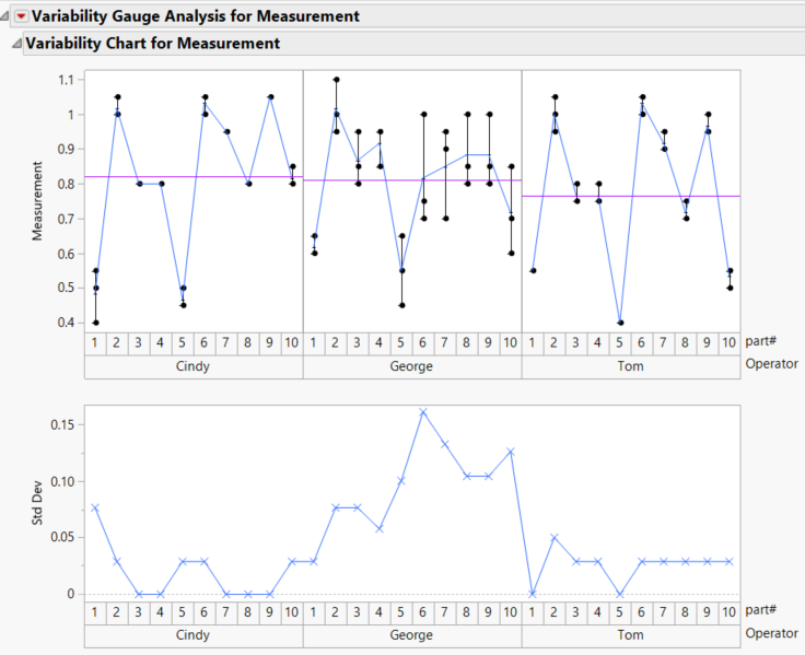

In this example, you want to identify the variation between three operators that each took three measurements of ten parts.

8. Click the Variability Gauge Analysis for Measurement red triangle and select Show Group Means and Connect Cell Means.
Figure 6.2 Example of a Variability Chart
Looking at the Std Dev chart, you can see that Cindy and George have more variation in their measurements than Tom, who appears to be measuring parts the most consistently. George seems to have the most variation in his measurements, so he might be measuring parts the most inconsistently.
