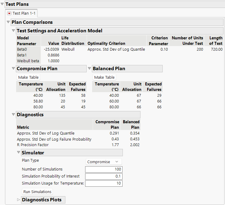

There are two test plans presented: a compromise and a balanced plan. Both plans allocate units across three temperature settings.
Note: The compromise plan allocates units to a temperature setting of 58.80. In practice, you would select a temperature as close to that value as possible within the precision of your temperature chamber.
Figure 22.2 Test Plans and Diagnostics
Use the diagnostics to compare the plans. For this acceleration model, both plans have similar metrics. Select the balanced plan if you are able to run three temperature settings with an even distribution of units otherwise, select the compromise plan.
Use the diagnostic plots to explore the sensitivity of the test plans to changes in the assumptions and to compare the plans. The distribution profiler gives the expected failure probability as a function of temperature and time for each plan. Explore how the failure probability changes for each plan across the time and temperature ranges. As observed in the diagnostics, the profilers also demonstrate that there is little difference between plans. The size of the intervals around the estimates gives a sense of the anticipated level of uncertainty for your test plan.
The R Precision Factor profiler gives the value of the metric for the temperature factor and quantile over a range of sample sizes. This gives you a sense of the anticipated uncertainty from the life test in relation to the number of samples under test. If you were able to increase your number of test units from 200 to 400, you could decrease the R precision factor. Ideally you would like the R precision to be less than one.
