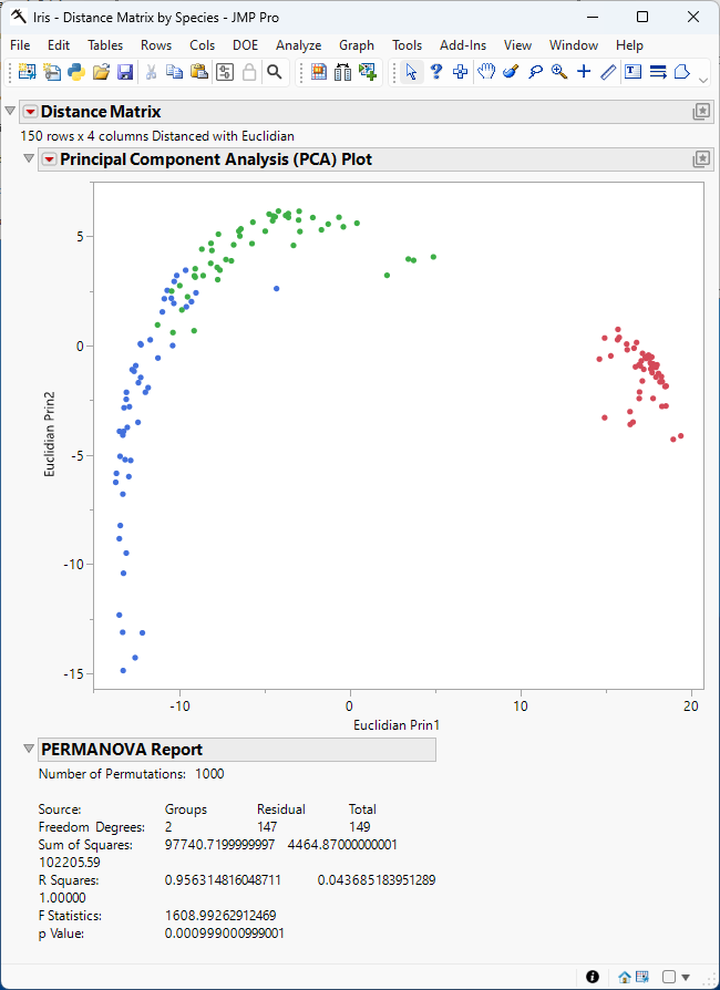

Figure 9.1 The Distance Matrix ReportĀ
The Principal Component Analysis (PCA) plot is shown above. Points corresponding to the observations in the input table are colored by species. The plot shows that the observations cluster by species and that variance in length and width of sepals and petals in irises is greatest between species.
