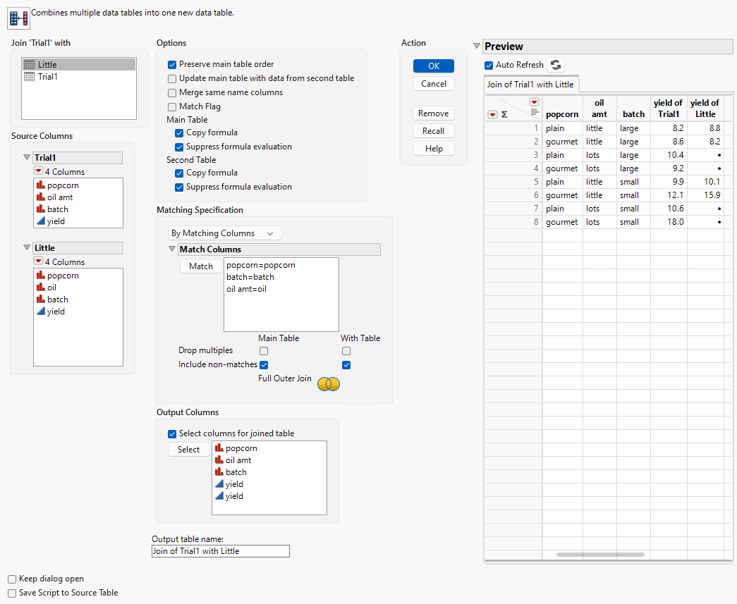

Figure 3.27 Completed Join Window
12. Click OK.

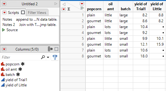

Figure 3.28 Joined Table
Joined Table
