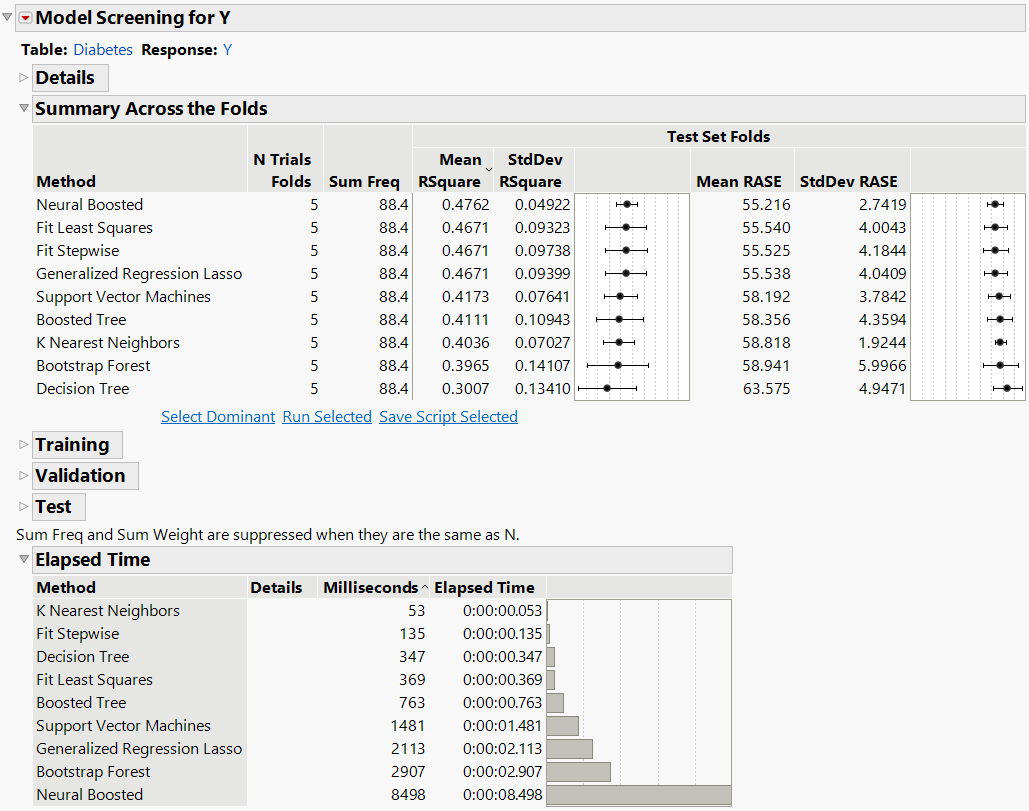

Image shown hereExample of Model Screening
You want to assess various models for their ability to predict diabetes disease progression. The data set includes baseline medical data for 442 patients who have diabetes and a continuous measure of diabetes disease progression obtained one year after each patient’s initial visit. Higher values correspond to more disease progression.

Figure 10.2 Model Report for Continuous Response
The best performing model, based on the Test RSquare averaged across the folds, is Neural Boosted. The average Test RSquare for Neural Boosted is 0.4762. The Elapsed Time report shows that the Neural Boosted models also took the longest to fit. In this case, the elapsed time was only 5 seconds, but this information could be important for larger data sets or more complex models.
