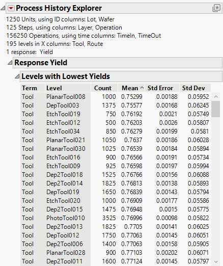

10. Click the Process History Explorer red triangle and select Levels with Lowest Yield.
Figure 28.2 Process History Explorer ReportĀ
The report contains information about the process, including the number of units, steps, operations, and levels in the X columns. The Levels with Lowest Yields table contains counts and yield information for the 195 levels in the X columns. Notice that the PlanarTool008 tool had the lowest yield and 1,000 units went through that tool.
