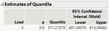

Time quantiles are desired for when 90% of jobs are finished under a system load of 5. See Meeker and Escobar (1998, p. 438).
7. Click the Parametric Survival Fit red triangle and select Estimate Quantile.
8. Type 5 in the first row beneath Load.
9. Type 0.9 in the first row beneath p.
10. Click Go.
Figure 6.3 Estimates of Time Quantile
The report estimates that 90% of the jobs will be done by 571 seconds of execution time under a system load of 5.
