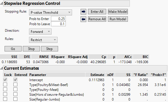

Figure 5.17 Stepwise Control Panel with P-value Threshold and Restrict Rule
Notice that when you switch from the default Rule of Combine to Restrict, the F Ratio and Prob > F values for two terms, Type{Poultry-Meat} and Size{Regular-Jumbo}, are shown as missing. This occurs because these two terms cannot enter the model until their precedent terms enter.

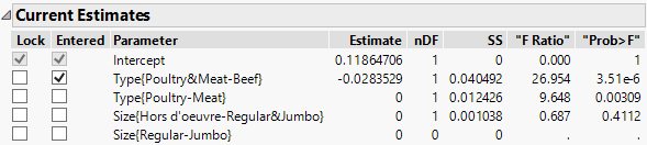

The term Type{Poultry&Meat-Beef} enters the model. This term has the smallest Prob>F value, and that value falls below the Prob to Enter threshold of 0.25.

The F Ratio and Prob>F values for the term Type{Poultry-Meat} appear. Because its precedent term has entered the model, Type{Poultry-Meat} is now allowed to enter.

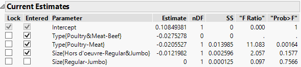

The term Size{Hors d'oeuvre-Regular&Jumbo} enters the model because its Prob>F value is 0.1577. Because its precedent term is now in the model, the term Size{Regular-Jumbo} is allowed to enter the model and its Prob>F value appears.
However, the Prob>F value for the term Size{Regular-Jumbo} is 0.7566, which exceeds the Prob to Enter value of 0.25. For this reason, if you click Step again, it is not entered into the model.
