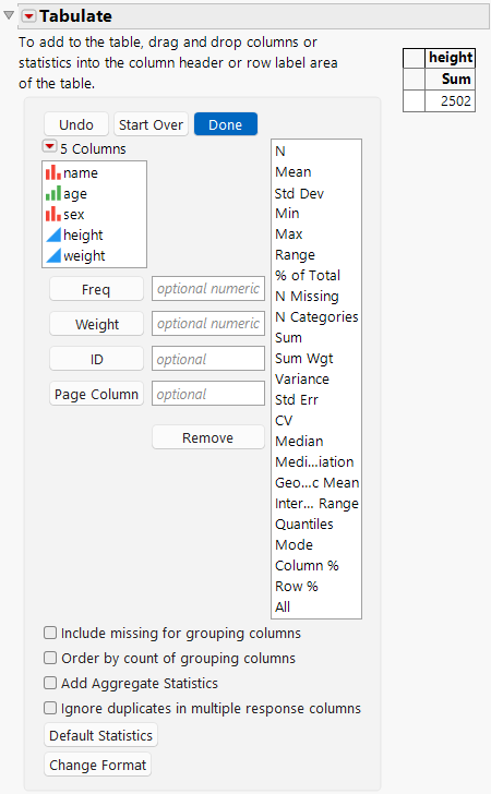

Since height is the variable that you are examining, you want it to appear at the top of the table.
3. Click height and drag it into the drop zone for columns.
Figure 9.3 Height Variable Added

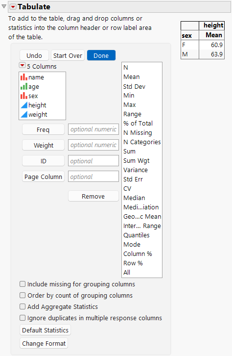

Instead of the sum, you want it to show the mean with two decimal places. You also want the overall mean.
5. Click Mean and drag it on top of Sum.
Figure 9.5 Mean Statistic Added
