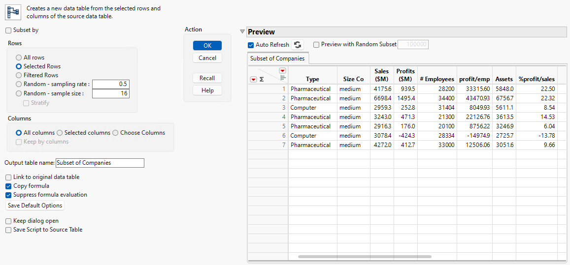

Create the Subset Table
7. Select Tables > Subset to launch the Subset window.
Figure 3.26 Subset Window
Subset Window
8. Select Selected columns to subset only the columns that you selected.
You can also customize your subset table further by selecting additional options.
9. Click OK.
The resulting subset data table has seven rows and three columns. For more information about the Subset option, see “Create a Subset Data Table” in Using JMP.
