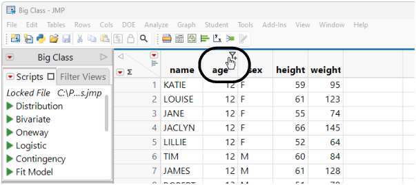

The first way is by hovering the mouse pointer over the upper right corner of a data table column name until the filter icon appears.
Figure 9.14 Filter on a Column
Filter on a Column
Click the filter icon to create a filter view with a filter on that column and then choose the filter criteria.

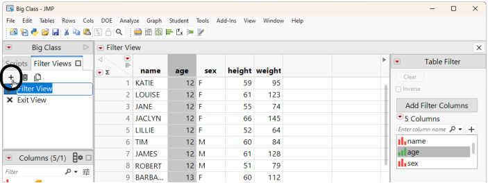

The second way to create a filter view is to click the Filter View tab and then click the New Filter View button (Image shown here). A filter view is created, and the Table Filter criteria are displayed to the right of the table.
Figure 9.15 Create a Filter View from the Filter Views Tab

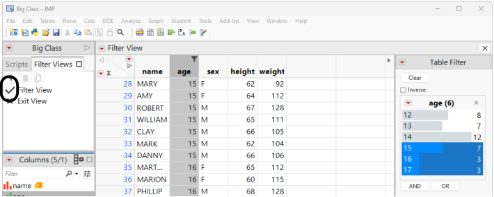

The active filter (the filter that is currently applied or being edited) has a check mark in the Filter Views tab.
Figure 9.16 The Active Filter View

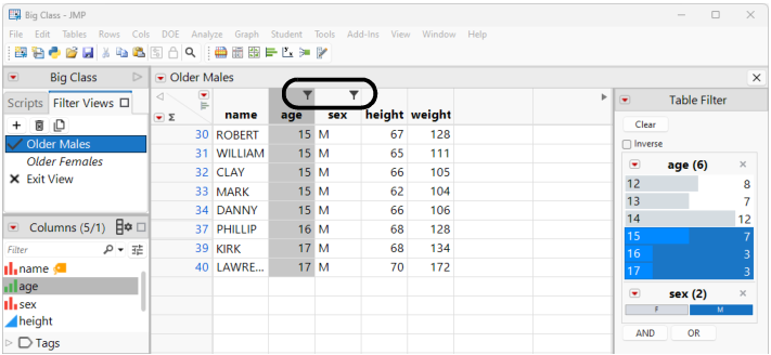

Columns that are used in a filter view display the filter icon.
Figure 9.17 Marked Filter View Columns

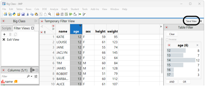

Save a Filter View
Filter views are temporary unless you save them to the table.
Filter views that are created from the Filter Views tab have a default name and can be saved to the table by selecting File > Save.
If the filter view was created by initially filtering on a column, click Save View to name the view on the Filter Views tab, and then select File > Save to save it to the table.
Figure 9.18 Save View
Save View

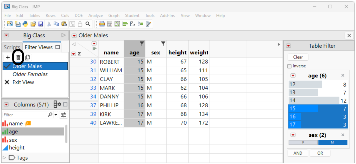

Delete a Filter View
From the Filter Views tab, select the filter view and click the delete icon.
Figure 9.19 Delete a Filter View
To restore a deleted filter view, use Edit > Undo.

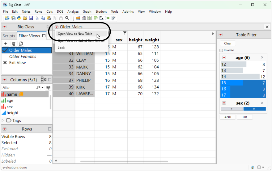

Create a Subset from a Filter View
To create a new table that is based on the active filter view, click the filter view menu and select Open View as New Table.
Figure 9.20 Open a Filter View as a New Table

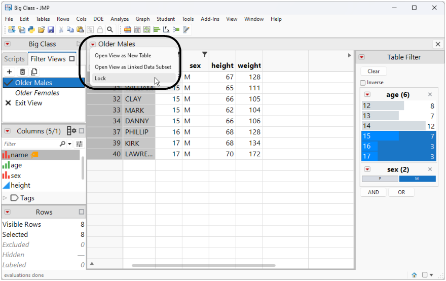

Lock a Filter View
To lock the active filter view, click the filter view menu and select Lock.
Figure 9.21 Lock a Filter View
Lock a Filter View
Locked filter view names are displayed in italics.
You can rename a locked filter view, but you cannot edit the filter criteria.

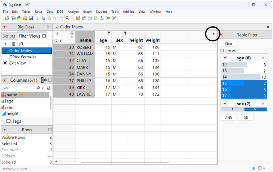

Open and Close the Filter Pane
If a Filter View is in effect, you can toggle the display of the Filter Views pane
Figure 9.22 Filter Pane Toggle
Filter Pane Toggle

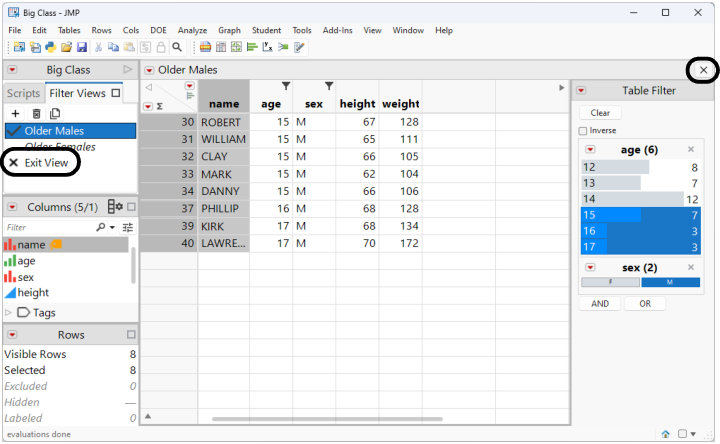

Exit Filter View
To return to an unfiltered view, click Exit View in the Filter Views tab, or “X” in the filter view banner.
Figure 9.23 Return to an Unfiltered View
