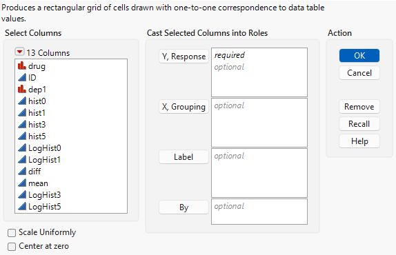

Launch the Cell Plot platform by selecting Graph > Cell Plot.
Figure 8.3 The Cell Plot Launch Window
Y, Response
Variables appear on the horizontal axis of the cell plot. Each cell represents a value.
X, Grouping
Produces a separate cell plot for each level of the variable.
Label
Labels each row by the specified variable. See Additional Example of the Cell Plot Platform.
By
Identifies a column that creates a report that consists of separate analyses for each level of the variable.
Scale Uniformly
Represents all variables on the same scale. Without this option, each variable is on a different scale.
Center at zero
Centers the cell plot at zero.
