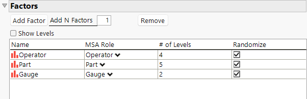

Measurement systems analysis experiments, also known as gage R&R studies, are based on full factorial designs. The MSA platform generates a full factorial design for a measurement systems analysis (MSA) experiment and provides design diagnostic measures. Diagnostics are available for crossed or nested models. For analysis of MSA experiments, see “Measurement Systems Analysis” in Quality and Process Methods.
Figure 25.1 MSA Factor Settings
MSA Factor Settings
