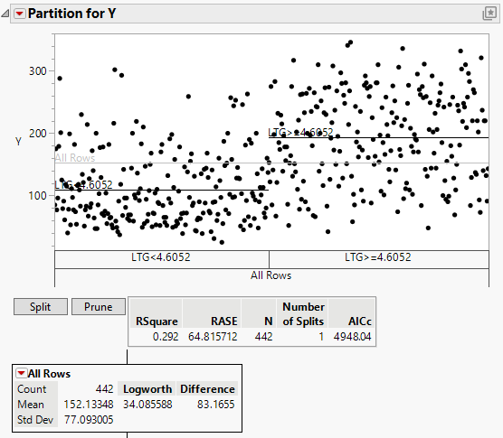

Partition Plot for a Continuous Response
If the response is continuous, the left vertical axis represents the values of the observations. There is an initial horizontal line on the plot that is the overall mean of the response. Once you begin splitting, additional horizontal lines are added to the plot. These lines represent the mean response value for each node of the decision tree. Splits are shown below the horizontal axis with a text description and a vertical line. Observations are reorganized into their respective nodes as splits are created or removed. The most recent split appears directly below the horizontal axis and on top of existing splits. The plot is updated with each split or prune of the decision tree.
Figure 4.6 Partition Report for a Continuous Response

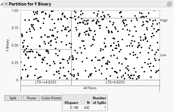

Partition Plot for a Categorical Response
If the response is categorical, the left vertical axis represents the proportion of each response outcome and the right vertical axis shows the order in which the response levels are plotted. There is an initial horizontal line on the plot that is the overall proportion of the first plotted response level. Once you begin splitting, additional horizontal lines are added to the plot. These lines show the proportion of the first plotted response level for each node of the decision tree. Splits are shown below the horizontal axis with a text description and a vertical line that splits the observations in the plot. The vertical lines extend into the plot and indicate the boundaries for each node. The most recent split appears directly below the horizontal axis and on top of existing splits. The plot is updated with each split or prune of the decision tree.
Figure 4.7 Partition Report for a Categorical Response
