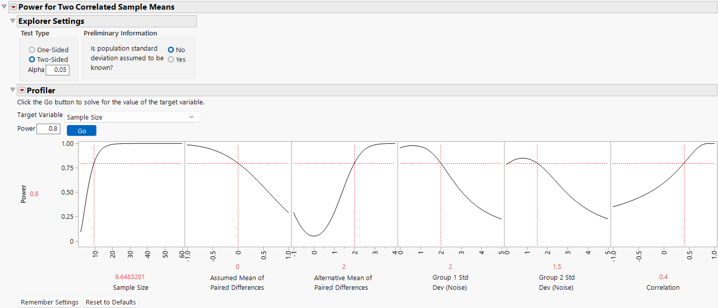

In this example, use the Power Explorer for Two Correlated Sample Means to estimate the number of subjects to use in an intervention study. You want at least 80% power to test for a difference in paired means of 2. The pre-measurements have an estimated standard deviation of 2 units. However, after treatment, you expect the standard deviation to be only 1.5 units. You are unsure about the correlation between the pre- and post-measurements, so you use a conservative value of 0.4. If the correlation is higher than 0.4, then you have more samples than needed for the specified power. Use a significance level of α = 0.05.
1. Select DOE > Sample Size Explorers > Power > Power for Two Correlated Sample Means.
2. Leave Test Type set to Two-Sided.
3. Leave Alpha set to 0.05.
4. Leave Target Variable set to Sample Size.
5. Leave Power set to 0.8.
6. In the Profiler, set the profilers to the following values:
– Assumed Mean of Paired Differences to 0.
– Alternative Mean of Paired Differences to 2.
– Group 1 Sted Dev (Noise) to 2.
– Group 2 Sted Dev (Noise) to 1.5.
– Correlation to 0.4.
7. Click Go to solve for the sample size with Power equal to 0.8
Figure 29.7 Two Correlated Mean Explorer
A sample size of 10 (determined by rounding 9.64 up to 10 subjects) enables the detection of a 2 unit difference in pre- and post-intervention results given the standard deviation and correlation assumptions.
