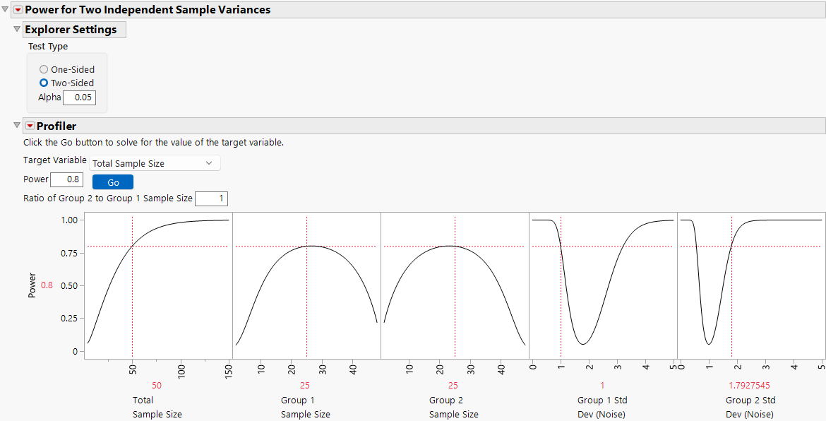

Example of Power Explorer for Two Independent Sample Variances
In this example, use the Power Explorer for Two Independent Sample Variances to evaluate how large of a difference in standard deviations can be detected with a total sample size of 50 samples. You desire at least 80% power to test for the difference in variances at a significance level of α = 0.05.
1. Select DOE > Sample Size Explorers > Power > Power for Two Independent Sample Variances.
2. Leave Test Type set to Two-Sided.
3. Leave Alpha set to 0.05.
4. Set Target Variable to Group 2 Std Dev (Noise).
5. Leave Power set to 0.8.
6. Leave Ratio of Group 2 to Group 1 Sample Size set to 1 for equal group sizes.
7. In the profiler, set Total Sample Size to 50.
Note that the values for Power and Group 2 Std Dev (Noise) updated.
8. Click Go to solve for the value of Group 2 Std Dev (Noise) with Power equal to 0.8.
Figure 29.6 Two Independent Sample Variances Explorer
With a total sample size of 50, with 25 in each group, you should be able to detect standard deviations that are 0.79 standard deviation units apart.
