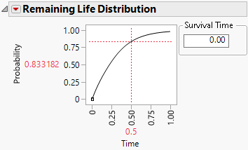

Image shown hereRemaining Life Distribution Profiler
The Remaining Life Distribution profiler for the system shows the probability that the system fails given that it has survived a specified amount of time, designated as Survival Time. By default, Survival Time is set to zero, and the remaining life distribution function is equivalent to the distribution function.
Enter a value for Survival Time to indicate the time to which the system has survived without failing. As an alternative to entering a value, select the small rectangle at the origin of the graph and drag it to the right to dynamically set the Survival Time.
Figure 13.17 Remaining Life Distribution
