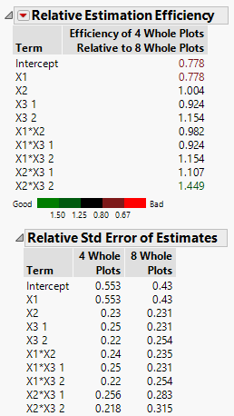

Figure 17.16 Relative Estimation Efficiency Comparing Two Split-Plot Designs
The relative estimation efficiency values are colored according to a color gradient shown under the table of relative estimation efficiency values. You can control the color legend using the options in the Relative Estimation Efficiency red triangle menu. See Color Legend.
