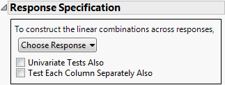

In the Manova Fit report, specify the response designs for various tests using the Response Specification panel.
Figure 10.4 Response Specification PanelĀ
Choose Response
Provides choices for response design, which forms the M matrix. The columns of an M matrix define a set of transformation variables for the multivariate analysis. You can choose among the following options for the M matrix:

Note: The most typical response designs are Repeated Measures and Identity for multivariate regression. There is little difference in the tests given by the Contrast, Helmert, Profile, and Mean options, since they span the same space. However, the tests and details in the Least Squares means and Parameter Estimates tables for them show correspondingly different highlights. The Repeated Measures and the Compound options show windows that enable you to specify response effect names. They then fit several response functions without waiting for further user input. Otherwise, selections expand the control panel and give you more opportunities to refine the specification.
Univariate Tests Also
Performs adjusted and unadjusted univariate repeated measures tests and multivariate tests. Use in repeated measures models.
Test Each Column Separately Also
Performs univariate ANOVA tests and multivariate tests on each response.
