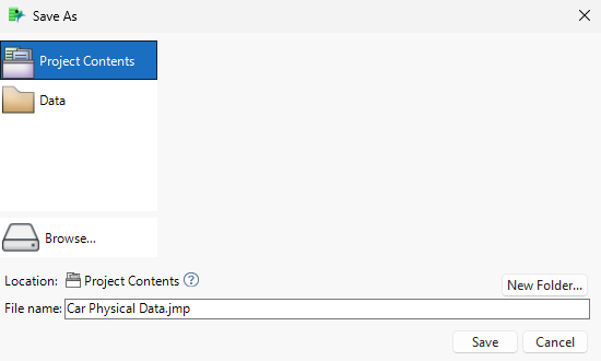

If you want to share, distribute, or archive your project, create a self-contained project by saving all your data tables and scripts to the project contents. This process embeds all project files and folders into a single project file that you can share with other JMP users.
1. (Optional) To save the project as a self-contained project, save each data table and script in the project by selecting File > Save As and then select Project Contents.
You can click New Folder to create a folder in the project contents.
Note: You do not need to save reports because reports are automatically saved to the project.
Figure 11.24 Save a Data Table to the Project ContentsĀ

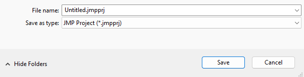

2. Select File > Save Project to save the project file.
Figure 11.25 Save a Project FileĀ
Save a Project File
