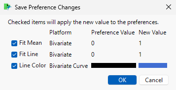

A window similar to the following image is displayed:
Figure 9.89 Save Preference ChangesĀ
3. Deselect any options that you do not want to save.
4. Click OK.
Your preferences have been updated with the new values. Preferences are usually only referenced when a platform starts (or reruns). If you made changes in the window, your new preferences might not be active until you rerun the platform.
