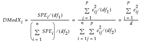

DModX
The DModXi value for each of the i observations is plotted on the DModX control chart. The normalized distance to model (DModX) is defined by the following ratio:
Equation shown here
where
eij = the residual for observation i and variable j
df1 = p−k
df2 = (n−k−1)(p−k) if the data is centered and (n−k)(p−k) if the data is not centered
n = number of historical data observations
k = number of PCA or PLS components
p = number of variables
Note: DModXi is equal to SPEi scaled by 1/d.
