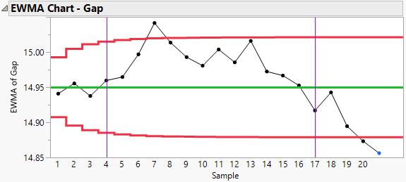

Shows or hides the vertical lines in the EWMA chart that designate shifts. Shift lines are drawn at the start of a shift. A shift start is defined as the first point after the EWMA value crosses the center line in a particular direction.
– A positive shift occurs when the EWMA value exceeds the upper limit on the chart. The start of the shift is defined as the first point after the most recent EWMA value below the Target line.
– A negative shift occurs when the EWMA value falls below the lower limit on the chart. The start of the shift is defined as the first point after the most recent EWMA value above the Target line.
Figure 11.5 Shift Lines Example
Shift Lines Example
In this example, the point for sample 7 is above the upper limit. Looking back from sample 7, the most recent point below the Target line is sample 3. Therefore, sample 4 is the first point above the Target line since the most recent point below the Target line and is denoted as the start of the positive shift.
Similarly, the point for sample 20 is below the lower limit and the most recent point above the Target line is sample 16. Therefore, sample 17 is denoted as the start of the negative shift.
