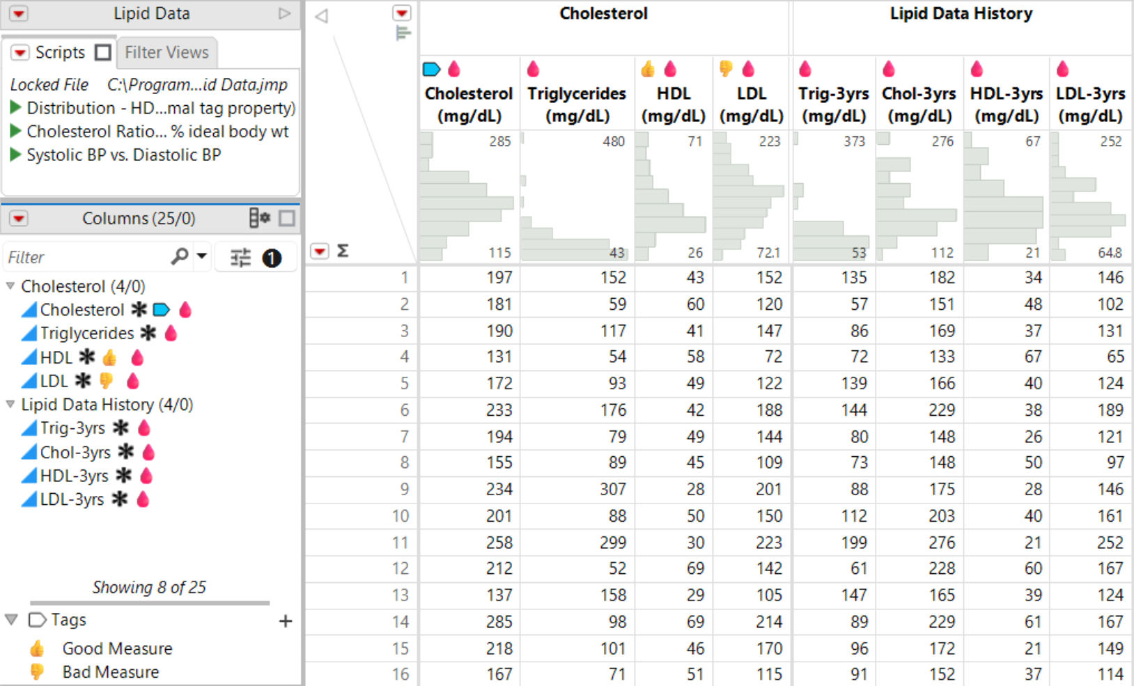

1. Select Help > Sample Data Folder and open Lipid Data.jmp.
2. In the Columns panel, select the More Column Filtering Options button (Image shown here).
3. Select the Image shown here Blood Measurements tag.
Figure 5.13 Filtering Columns by Tag in the Columns Panel
