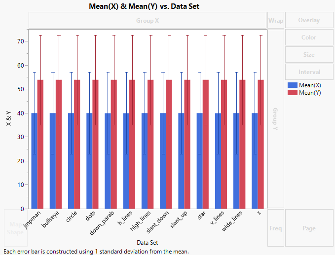

1. Select Help > Sample Data Folder and open JMP Man Dozen.jmp.
3. Select X and Y and drag them to the Y zone.
4. Select Data Set and drag it to the X zone.
5. Click the Bar element Image shown here.
6. For the Error Interval, select Standard Deviation.
Figure 9.55 Original Graph for JMP Man Dozen.jmp
Notice that the mean and standard deviation for these observations are the same, so this graph does not tell you much. Use preset graphs to get more insight into the data.

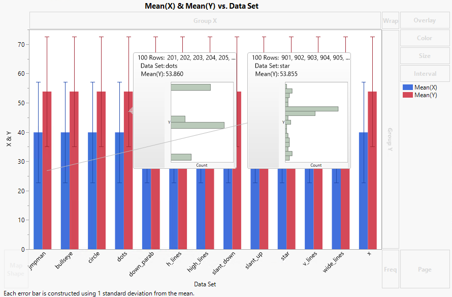

1. In the graph, right-click and select Hover Label > Histogram.
This adds preset histograms to the hover labels.
2. Point to some of the bars.
In this example, point to the red bars for dots and star.
Tip: To make the hover label remain so that you can compare it with other hover labels, click the Pin icon Image shown here in the upper right corner of the hover label. See Pin Hover Labels in JMP Graphs.
Figure 9.56 Example of Preset Histograms
Notice that the distribution for the measurements is clearly different. But you want to see another type of graph, a scatterplot.

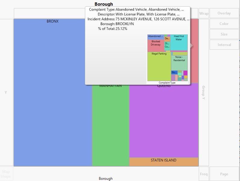

5. Right-click on the graph and select Hover Label > Treemap.

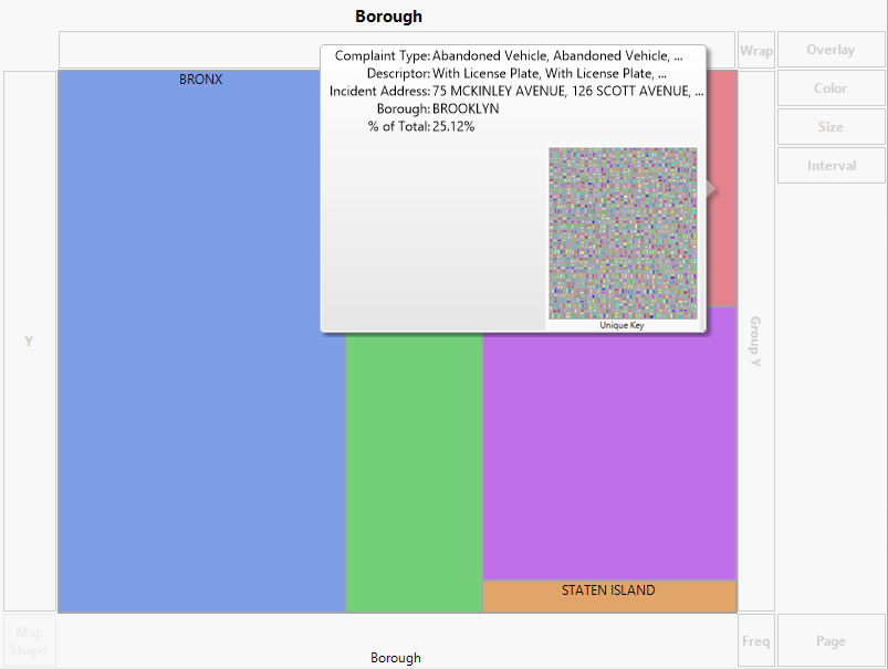

6. Put your cursor over Brooklyn to see the hover label graph.
Figure 9.58 Initial Hover Label Graph for Brooklyn
The hover label graph shows the number of incidents in each borough by the unique key. Instead, in this example, you want to see the number of incidents in each borough by the type of complaint.

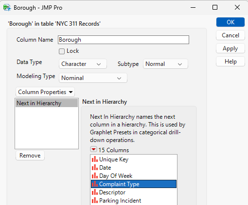

1. In the NYC 311 Records.jmp data table, right-click the Borough column heading and select Column Properties > Next in Hierarchy.
2. Under Next in Hierarchy, click Complaint Type.
Figure 9.59 Complaint Type Selected for Next in Hierarchy
3. Click OK.
4. Add a second level of the hierarchy that appears if the first hover label graph is launched:
a. In the NYC 311 Records.jmp data table, right-click the Complaint Type column.
b. Select Column Properties > Next in Hierarchy.
c. Under Next in Hierarchy, click Descriptor.
d. Click OK.

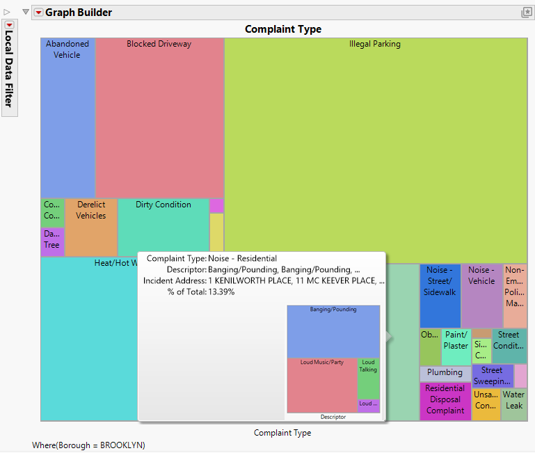

5. In Graph Builder, put your cursor over Brooklyn again to see the updated hover label graph.
Figure 9.60 Updated Hover Label Graph for Brooklyn
The hover label graph is now showing the number of incidents in each borough by the type of complaint.
6. Click the hover label graph to launch it.
7. Put your cursor over Noise-Residential.
Figure 9.61 Second Level Hover Label Graph for Residential Noise Complaints
The second level of the hover label graph is showing the number of incidents in the residential noise complaints category by the descriptor.

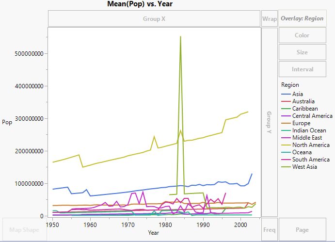

3. Select Pop and drag it to the Y zone.
4. Select Year and drag it to the X zone.
5. Select Region and drag it to the Overlay zone.
6. Click the Line element Image shown here.
Figure 9.62 Mean Population by World Region Per Year

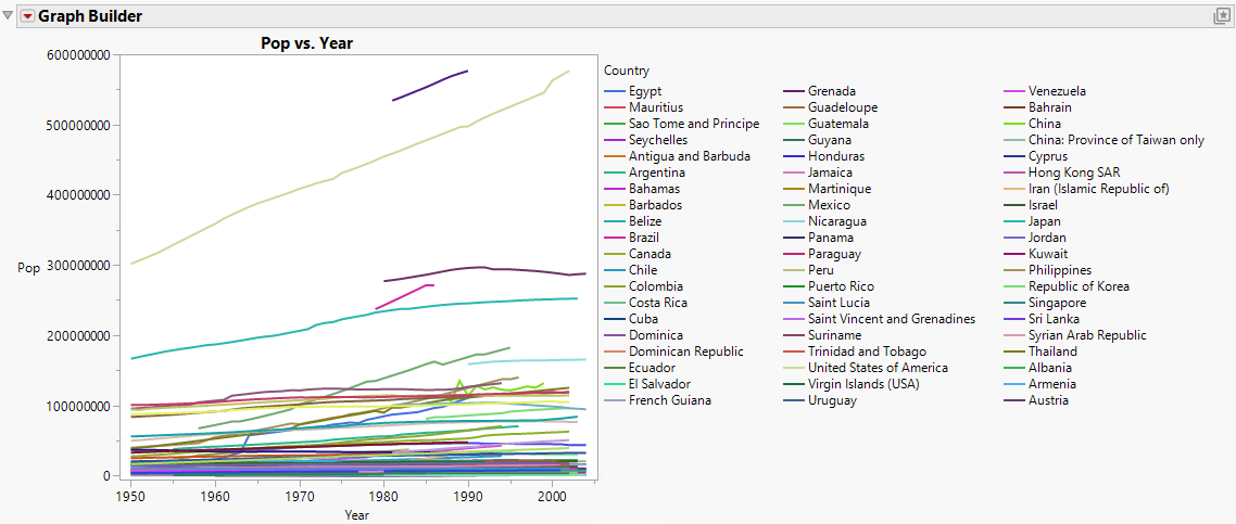

This graph shows the mean population in each world region over different years. In the hover label graphs, you want to see a more granular view that shows the impacts by country instead of region.
7. Keep this window open.
Copy and Paste a Graph
1. Click the Graph Builder red triangle and select Redo > Redo Analysis.
A copy of the original graph appears.
2. In the copy of the graph, select Country and drag it to the Overlay zone.
This replaces Region with Country.

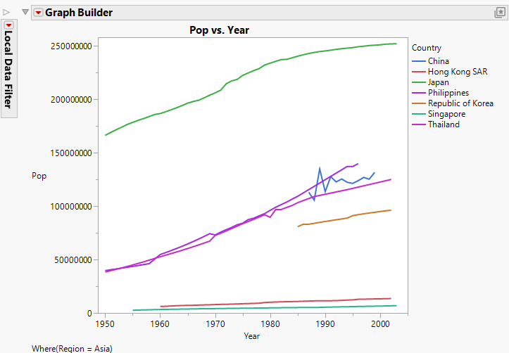

6. In the original graph, right-click and select Hover Label > Paste Graphlet.

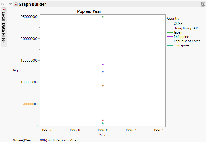

7. Hover over the Asia line and click to launch the hover label graph.
Figure 9.64 Hover Label Graph That Shows Population by Country and Year for the Asia Region
Because you are still filtering by year, this view is too granular to be useful. You want to remove the year filter, so that the graph filters only by region.
8. Close the hover label graph for the Asia region.

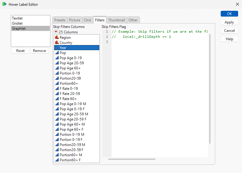

Remove a Filter Column
1. Right-click the original graph and select Hover Label > Hover Label Editor.
2. In the Graphlet window, click the Filters tab.
3. Select Year, the column that you no longer want to filter by.
Figure 9.65 Skip Filters in the Hover Label Editor
4. Click OK.
5. Hover over the Asia line and click to launch the hover label graph.
Figure 9.66 Hover Label Graph That Shows Population by Country and Year for the Asia Region
Notice that the hover label graphs are no longer filtering by year, but by region only, creating a more useful visualization.

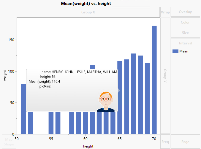

For labeled columns, hover labels can contain an image from the first labeled image column and up to four values from labeled text columns. To show more labeled images or text observations, use the Label Viewer.
1. Select Help > Sample Data Folder and open Big Class Families.jmp.
3. Select weight and drag it to the Y zone.
4. Select height and drag it to the X zone.

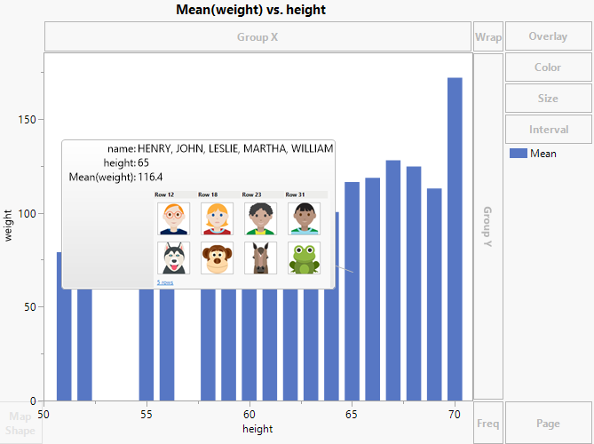

6. Hover over the bar for the height of 65 inches and click the Pin element Image shown here.
Figure 9.67 Hover Label with Only Initial Image
Although five names are included in this bar, only the first image appears in the hover label. You want to see more images in the hover label.
7. Right-click in the graph and select Hover Label > Label Viewer.
Figure 9.68 Hover Label with Multiple Images
The maximum of eight images now appear in the hover label.
8. To see the additional image, click a thumbnail in the hover label.
9. In the Label Viewer, click the Forward arrow Image shown here to see the fifth image.
