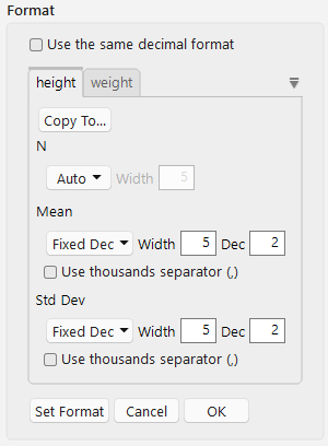

Change Numeric Formats
The default format of each cell depends on the analysis column and the statistics. To change default formats, click the Change Format button at the bottom of the Tabulate window. This opens a panel that enables you to specify formats. Select the Use the same decimal format option to apply the same format to all elements. Otherwise, specify formats for each element.
The Format panel has a tab for each analysis column and a list of formats for each statistic. Use the list of formats to select the format for the statistic. The choice of format determines the remaining options to the right of the list of formats.
When there are two or more analysis columns, the format panel includes a Copy To button. Select this button to copy formats to other analysis columns.
The panel includes the following buttons to apply changes:
Set Format
Applies changes made to formats. The panel remains open.
Cancel
Cancels changes made to formats.
OK
Applies changes made to formats and closes the panel.
Figure 9.9 Format Tabulate Elements
