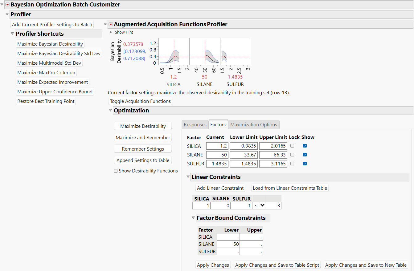

Add Linear Constraints to Factors
6. Click the gray triangle next to Bayesian Optimization Batch Customizer.
7. Click the red triangle next to Augmented Acquisition Functions Profiler and select Optimization and Desirability > Optimization Control Panel.
8. In the Optimization section, click the Factors tab.
9. In the Factors tab, click the gray triangle next to Linear Constraints.
10. In the Linear Constraints section, click Add Linear Constraint.
11. Enter the following constraint: 1*SILICA + 1*SULFUR ≤ 3.
12. Click the gray triangle next to Factor Bound Constraints.
13. Type 50 in the box for the lower bound for SILANE.
14. Click Apply Changes.
Figure 18.6 Augmented Acquisition Functions Profiler with Constraints
Note that the linear constraint and the factor bound constraint are reflected in the Augmented Acquisition Functions Profiler.

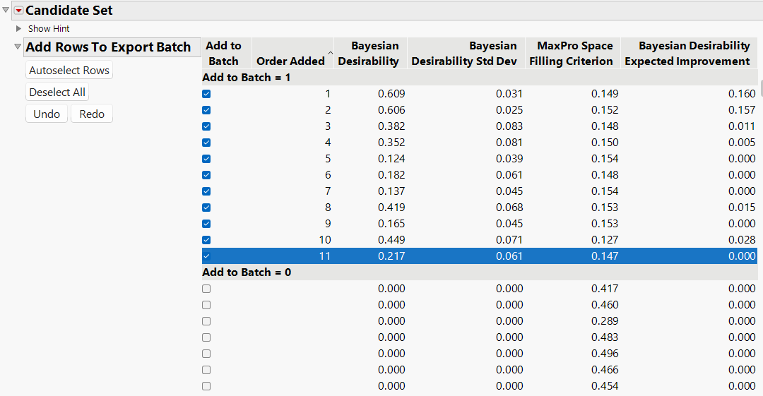

19. In the Candidate Set report, click Autoselect Rows.
20. Type 10 next to Number of Points to Propose. Check that the selected Augmentation Method is Refine Model.
21. Click Select Rows.
Figure 18.7 Selected Batch of Runs
Additional runs are added to the top section of the candidate set table. This indicates that they are to be included in the next batch.
