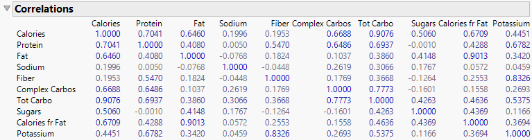

The Multivariate report appears. The report contains the Correlations report and Scatterplot Matrix by default. The Correlations report is a matrix of correlation coefficients that summarizes the strength of the linear relationships between each pair of response (Y) variables. The darker blue numbers indicate a higher degree of correlation.
Figure 6.7 Correlations Report
Correlations Report
Note the following points:
– In the Calories column, the number of calories is highly correlated with all variables except for sodium and fiber.
– In the Fiber column, fiber and potassium appear to be highly correlated.
– In the Sodium column, sodium is not highly correlated with the other variables.

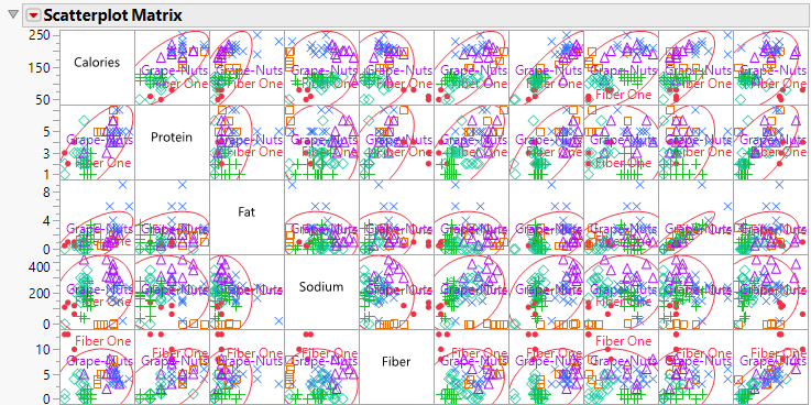

The density ellipses in the Scatterplot Matrix further illustrate relationships between variables.
4. From the red triangle next to the Scatterplot Matrix outline, select Density Ellipses.
This displays a 95% bivariate normal density ellipse in each scatterplot.
Figure 6.8 Portion of the Scatterplot Matrix
Assuming that each pair of variables has a bivariate normal distribution, the density ellipse encloses approximately 95% of the points. If the ellipse is relatively round and is not diagonally oriented, the variables are uncorrelated. If the ellipse is narrow and diagonally oriented, the variables are correlated.
– The ellipses are relatively round in the Sodium row. This shape indicates that Sodium is uncorrelated with other variables.
– The blue x markers, which represent Nat. Bran Oats & Honey, Cracklin’ Oat Bran, and Banana Nut Crunch, appear outside the ellipses in the Fat row. This placement indicates that the datum is an outlier (because of the amount of fat in the cereal).

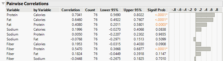

5. Click the Multivariate red triangle and select Pairwise Correlations to show the Pairwise Correlations report.
Figure 6.9 Portion of the Pairwise Correlations Report
The Pairwise Correlations report lists the Pearson product-moment correlations for each pair of Y variables. The report also shows significance probabilities and compares the correlations in a bar chart.

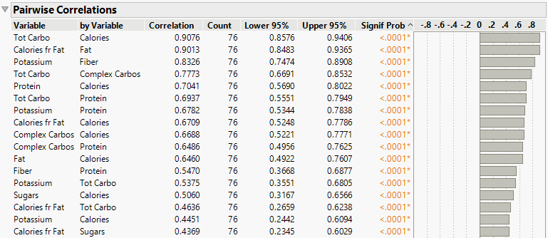

6. To quickly see which pairs are highly correlated, right-click in the report and select Sort by Column, Signif Prob, and the Ascending check box, and then click OK.
The most highly correlated pairs appear at the top of the report. The small p-values for the pairs indicate evidence of correlation. The most significant correlation is between Tot Carbo (total carbohydrates) and Calories.

The Correlations report and Scatterplot Matrix show that the number of calories is highly correlated with all variables except for sodium and fiber. The Pairwise Correlations report shows that Tot Carbo (total carbohydrates) and Calories is the most correlated pair of variables.
Which pairs of variables are not correlated?
The Correlations report and Scatterplot Matrix show that Sodium is not correlated with the other variables.
