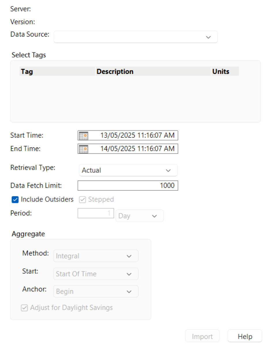

Figure 3.60 Import from AspenTech IP.21 Server Window
Select and specify the following information, in the order in which it is listed:
Data Source
Specifies from the available data sources on the server.
Start Time
Specifies the beginning of the time period for the data that you want.
Note: Start Time and End Time values are specified in the format MM:DD:YYYY HH:MM:SS.
End Time
Specifies the end of the time period for the data that you want.
Retrieval Type
Specifies how the server processes or filters the data before sending it to a data table. The created data table is populated with a table variable with the name “Retrieval Type” and whose value is the type specified in the import wizard.
