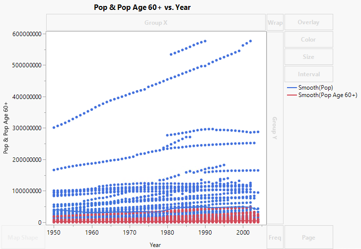

The PopAgeGroup.jmp sample data table contains world region populations by age and year. The Pop column contains country population by year, and the Pop Age 60+ column contains the population aged 60 and older. You want to show these two variables on a single chart.
1. Select Help > Sample Data Folder and open PopAgeGroup.jmp.
3. Select Pop and PopAge 60+ and drag them to the Y zone.
4. Select Year and drag it to the X zone.
Figure 3.14 Pop and Pop Age 60+ Merged

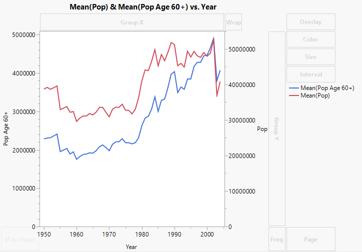

To make the Pop Age 60+ values more visible, calculate yearly means and then add a second Y axis.
5. In the Points options panel, set the Summary Statistic to Mean.
6. Click the Line element Image shown here.
7. Right-click the variable names in the Y zone and select Move Right > Pop.
Figure 3.15 Second Y Axis Added
Second Y Axis Added
An axis for Pop is added on the right side of the graph, and the axes rescale to show both sets of values. You can now see relationships between the two measures. For example, both measures began to decrease in 2002.
