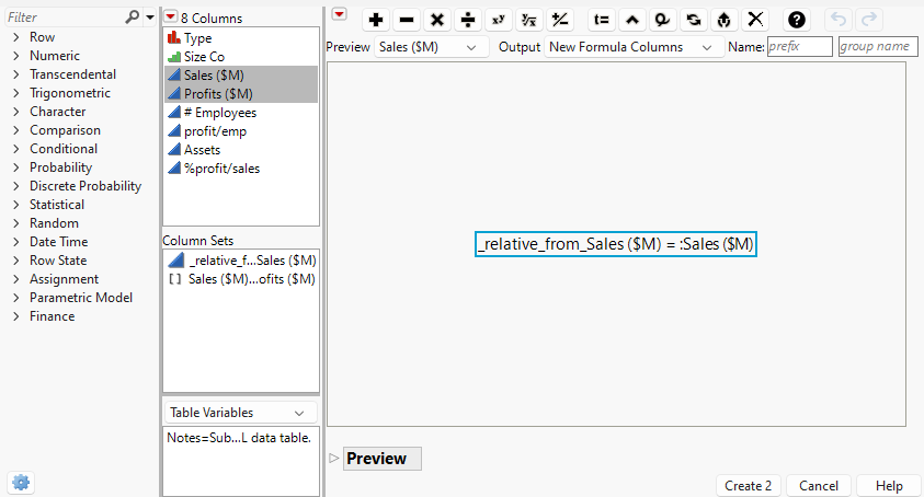

The following example shows how to open the Formula Editor for one or more columns:
1. Select the columns that you want to transform and right-click in their column header.
2. Select New Formula Column > Formula
The Formula Editor appears for the selected columns.
Figure 4.46 Creating Formula Columns with the Formula Editor
Column Sets
Use the Column Sets panel to work with sets of columns. This panel is available by selecting multiple columns and opening the Formula Editor. Use these sets as formula elements with functions that operate columnwise, like Sum and Median.
Two initial sets are available when working with multiple columns.
The first set option, the floating column reference, is represented by the data type of the columns and prefixed by “_relative_from_”. This option treats each element of the set individually.
The second option, represented by the list icon Image shown here, is a list of the entire group. This option treats all elements of the set as one list.
