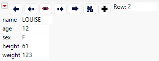

Use the Row Editor to browse or edit cells one row at a time. Open the Row Editor in one of the following ways:
• Select Rows > Row Editor.
• In a data table, double-click in the row number area. The row that you use is the row that first appears in the Row Editor.
• In a report window, right-click in a plot or graph and select Row Editor.
Figure 4.21 Row Editor
Row Editor
Note the following tips:
• If you have a report window open, and you want edited data to be automatically reflected there, make sure that Automatic Recalc is turned on. See “Automatic Recalc”.
• If your data table contains value labels, the Row Editor displays the label, and when the cell is highlighted for editing, it shows the actual value. See “SPSS Label, Long Name, and SAS Label”.
Row Editor Buttons
Click the arrow buttons to browse through selected rows or the entire data set if no rows are selected.
Image shown here Shows the previous row.
Image shown here Shows the previously selected row.
Image shown here Makes the row blink in graphs.
Image shown here Shows the next selected row.
Image shown here Shows the next row.
Image shown here Searches for a row. See Select Rows That Contain Specific Values.
Image shown here Creates a new row at the end of the data table.
Note: Changes made to a row by using the Row Editor are written to the data table when you change fields in the Row Editor. You still must save the changes to the data table.

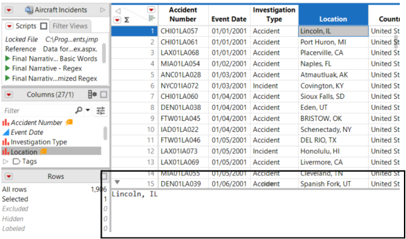

The Data Grid Edit pane lets you edit any cell’s value in a dedicated panel, making it easier to work with all types of data. Use the Data Grid Edit pane to isolate a cell’s value to modify it without interfering with other cells in the data table.
Click the Open Edit Pane button Image shown here in the lower left corner of a data table to open the Data Grid Edit pane.
Figure 4.22 The Opened Data Grid Edit Pane

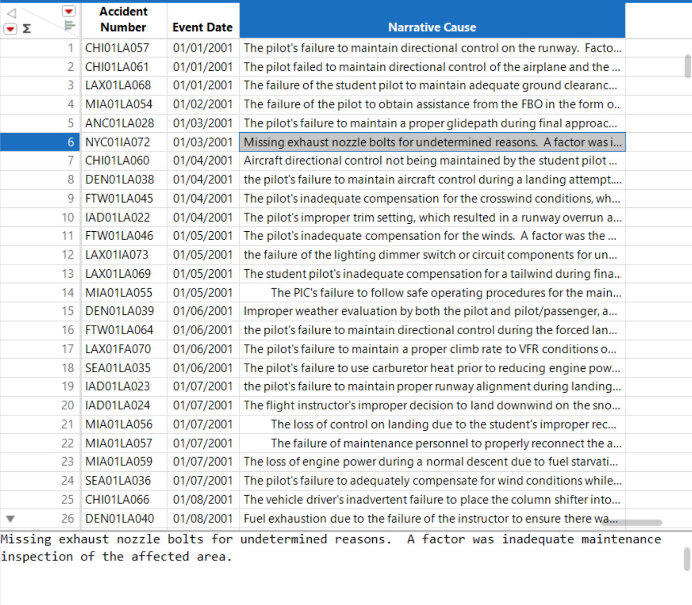

Example of Editing a Long Text Value with the Data Grid Edit Pane
In this example, the data table has a column of narratives describing aircraft incidents that were reported to the National Transportation Safety Board. Cells with long text values like these narratives can be difficult to edit within a data table, so you use the Data Grid Edit pane to edit the text values more easily.
1. Select Help > Sample Data Folder and open Aircraft Incidents.jmp.
2. Scroll to the right-most side of the data table.
3. Select cell 6 of the column Narrative Cause.
4. Click the Open Edit Pane button in the lower left corner of the data table.
The Data Grid Edit Pane opens.
Figure 4.23 Displaying a Long Text Value in the Data Grid Edit Pane
5. In the Data Grid Edit Pane, delete the word “maintenance” from the text value.
6. Select any area back within the data table.
7. To confirm the change, select cell 6 of the column Narrative Cause again.
