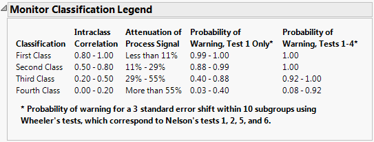

Monitor Classification Legend
The EMP Results report contains a Monitor Classification Legend, which describes the system and classification parameters in the Measurement Systems Analysis platform.
Figure 4.6 Monitor Classification Legend
This legend describes the following classifications: First, Second, Third, and Fourth Class. Each classification indicates the following information:
• The corresponding Intraclass Correlation values
• The amount of process signal attenuation (decrease)
• The chance of detecting a 3 standard error shift within 10 subgroups, using Wheeler’s test one or all four tests
Wheeler (2006) identifies four detection tests known as the Western Electric Zone Tests. Within the Shift Detection Profiler, there are eight tests that you can select from. The tests that correspond to the Wheeler tests are the first, second, fifth, and sixth tests.
Tip: To prevent the legend from appearing, deselect Show Monitor Classification Legend in the EMP Measurement Systems Analysis platform preferences.
