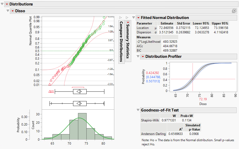

4. In the Disso menu bar, click the Platform Presets button Image shown here and select Sample Presets > Check Normality.
Figure 10.2 The Distribution Report Updated by the Check Normality Platform Preset
The Check Normality Platform Preset minimizes the Summary Statistics and adds the following information to the report window:
• A Normal Quantile Plot of the Disso variable
• The Fitted Normal Distribution report
• A Distribution Profiler
• A Goodness-of-Fit Test
Because the normal quantile plot approximates a straight diagonal line, the Disso variable appears to be normally distributed.
