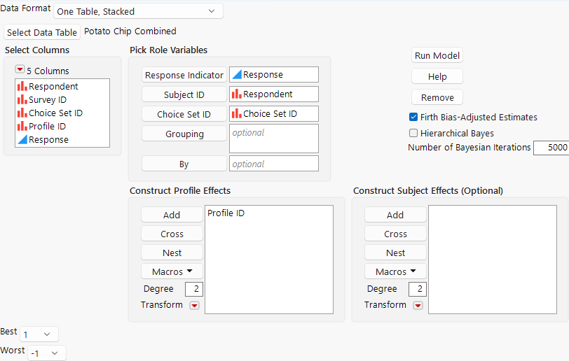

5. Assign roles to columns to complete launch dialog as follows:
– Select Response and click Response Indicator.
– Select Respondent and click Subject ID.
– Select Choice Set ID and click Choice Set ID.
– Select ProfileID and click Add in the Construct Profile Effects panel.
Figure 5.2 Completed MaxDiff Launch Window
Note that the setting for Worst choice changed to -1 when you specified the Response column as the Response Indicator variable.

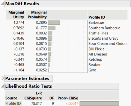

Figure 5.3 MaxDiff Report for Potato Chip Combined.jmp
The report indicates that Profile ID is significant, indicating that preferences for the various chip types differ significantly. The highest Marginal Utility is for Barbecue chips. The estimated probability that Barbecue chips are preferred to other chip types is 0.2895.
