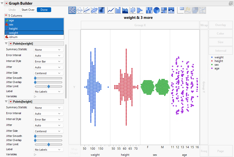

3. Select age, sex, height, and weight, press Shift, and click the X zone.
Figure 6.4 Adding Variables to the X Zone

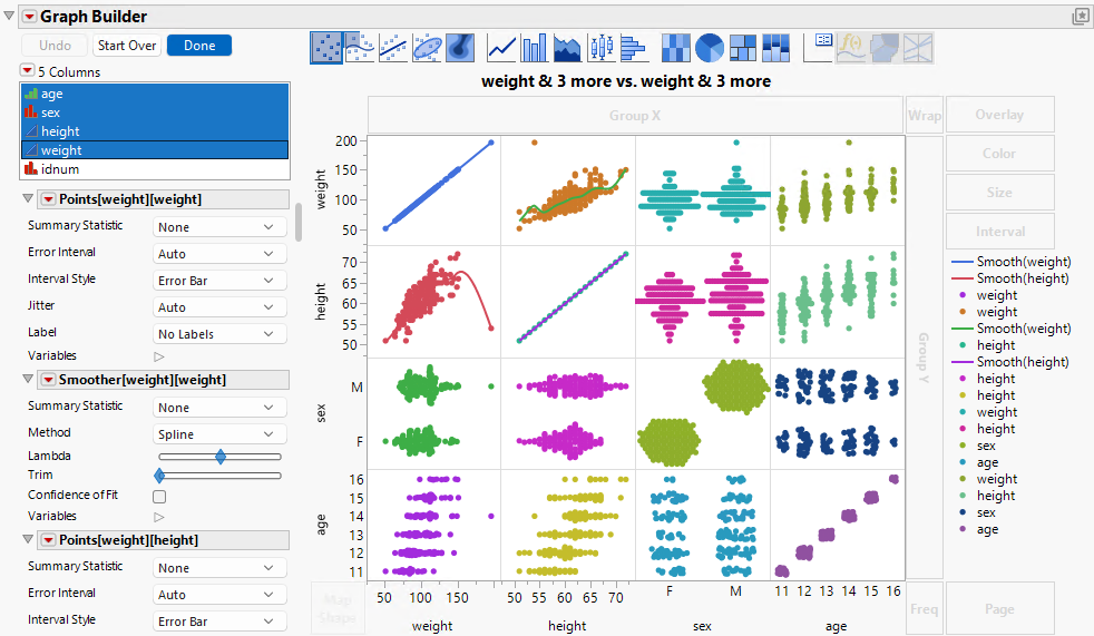

4. Select age, sex, height, and weight, press Shift, and click the Y zone.
Figure 6.5 Adding Variables to the Y Zone

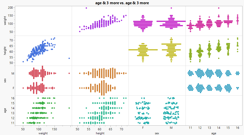

Figure 6.6 Scatterplot Matrix in Graph Builder
