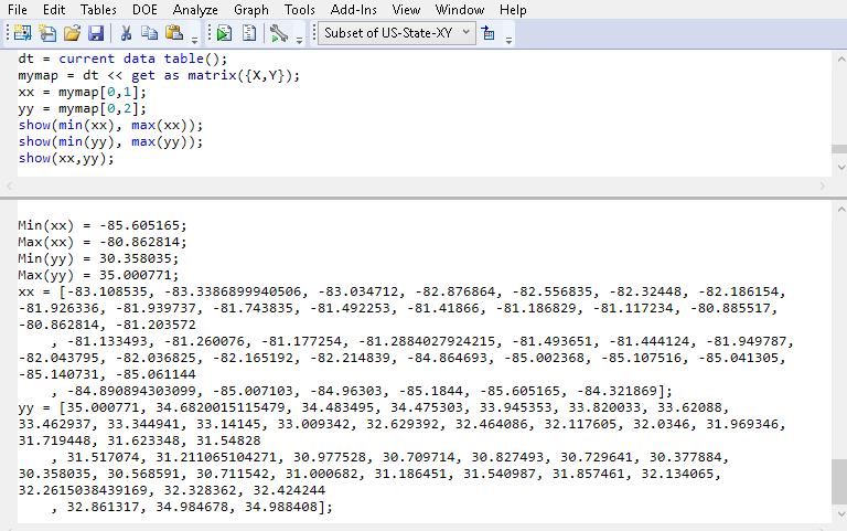

1. Select File > New > Script. In the script window, right-click and select Show Embedded Log.
2. Copy the following and paste it into the new script:
dt = current data table();
mymap = dt << get as matrix({X,Y});
xx = mymap[0,1];
yy = mymap[0,2];
show(min(xx), max(xx));
show(min(yy), max(yy));
show(xx,yy);
3. With the subset of the US-State-XY.jmp table active, run the script.
The range of values for the latitudes and longitudes in Georgia and the xx and yy matrices appear in the log.

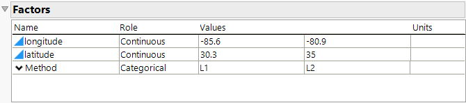

1. Select DOE > Special Purpose > Space Filling Design.
2. Add two continuous factors to the design. Enter 2 in the Add N Factors text box and click Continuous.
3. Rename the factors longitude and latitude and enter their min and max values in the Factor section:
– For longitude, enter -85.6 and -80.9 as the values. These are the min and max longitude values from the log for x.
– For latitude, enter 30.4 and 35.0 as the values. These are the min and max latitude values from the log for y.
4. Add a categorical factor. Click Categorical > 2 Level. Rename the factor Method.
Figure 21.18 Factors
Factors
5. Click Continue.

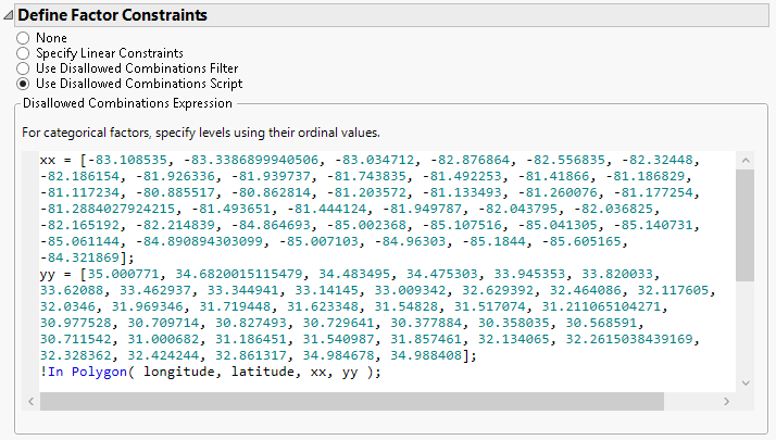

1. Select Use Disallowed Combinations Script to open the Disallowed Combinations Expression text box.
The ranges of longitude and latitude define a square. The state of Georgia is a polygon, not a square. You want to disallow points that fall outside of the state of Georgia polygon.
2. Go to your script window and copy the xx and yy matrices from your script log. Paste this into the Disallowed Combinations Expression text box.
3. At the end, add the following line:
!In Polygon(longitude, latitude , xx, yy);
This excludes points that are not in the polygon defined by the xx and yy coordinates.
Figure 21.19 Disallowed Combinations Expression

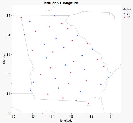

1. Change the Number of Runs to 40 and click Fast Flexible Filling.
2. Click Make Table.
3. From your design table, select Graph > Graph Builder.
4. Drag these columns into these zones:
– longitude to the X zone
– latitude to the Y zone
– Method to the Color zone
5. Above the graph, click the Smoother element icon to turn it off.
6. To add the state shape, right-click the graph and select Graph > Background Map.
7. Under Boundaries, select US States and click OK.
Figure 21.20 Example of FFF Design for the US State of Georgia
Note: The exact location of the points on your map might differ from the one shown due to the random starting point for the FFF algorithm.
The map identifies the 40 locations where you should collect your samples. The sampling method (L1 or L2) is indicated by the color of the points.
