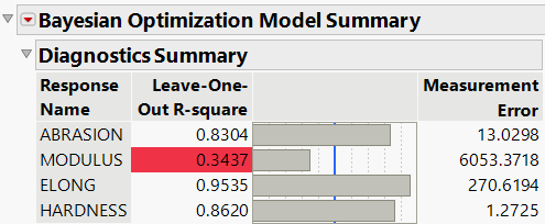

9. Click the Model Summary tab.
Figure 18.2 Diagnostics Summary
Diagnostics Summary
The Model Summary tab contains a report that includes a table of diagnostic summaries for each response model. The response MODULUS is highlighted in red because the Leave-One-Out RSquare value is lower than the threshold that you specified in the launch window. Because one of the individual models has a RSquare value that is lower than the threshold, the platform uses the Space Filling Exploration method by default to select batch runs.
Note: In general, your results might vary due to the random nature of fitting Gaussian Process models.

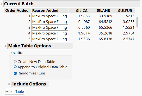

10. Click the Batch Selection tab.
Figure 18.3 Batch of Runs Auto Selected by Space Filling Exploration
The table in the Current Batch section contains the runs that were automatically selected by using the Space Filling Exploration algorithm. There are 10 runs, as you specified in the launch window.
11. Click Make Table.
After you click Make Table, the batch of 10 runs is added to the original data table. Also added to the data table are an Iteration column, a Reason Added column, and a start-up script. After you collect responses for the 10 runs, enter the data into your data table, and then use the BO Start Up Script for Batch 1 to return to the analysis. Continue in an iterative manner by collecting new data as needed until your responses are optimized.
