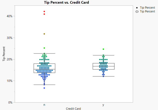

Build a Graph
1. Click Graph > Graph Builder.
Note: A step named Launch platform: Graph Builder is added to the workflow.
2. Drag Credit Card to the X axis.
3. Drag Tip Percent to the Y axis.
4. Press Shift and click the Box Plot element Image shown here.
5. Click Done.
Figure 7.13 Graph Builder For Tip Percentage by Credit Card Type
6. To confirm that the graph is complete, close the Graph Builder window.
Note: The step named Launch platform: Graph Builder is replaced with a Report snapshot step.

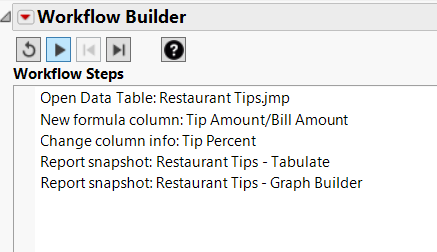

Stop Recording and Test the Workflow
1. Click Image shown here to stop recording.
2. (Optional) Click the Workflow Builder red triangle and select Display Options > Presentation Mode.
Figure 7.14 Workflow Builder in Presentation Mode
3. Click Image shown here to reset. This closes any open windows and resets the workflow to the start.
Note: The reset button closes only those windows that were opened by the workflow. The reset button does not close message windows.
4. Click Image shown here to test the workflow.
Tip: You can perform these steps to test your workflow at any time. You can continue to edit the workflow after testing.
