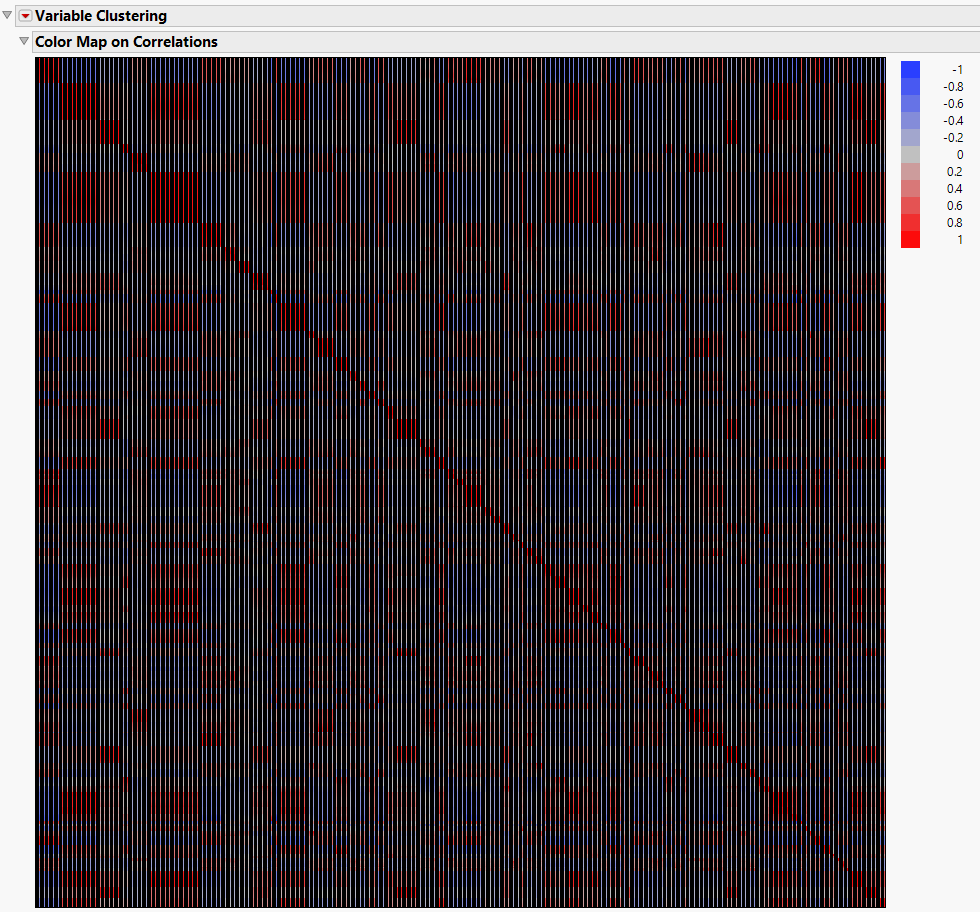

6. Click the gray disclosure icon next to Color Map on Correlations.
7. (Optional.) Right-click the color map and select Frame Size.
8. (Optional.) Type 850 in the boxes next to Horizontal and Vertical, and click OK.
Figure 17.5 Color Map on Correlations
The color map of the correlations between the 667 variables places variables that belong to the same cluster adjacent to each other.

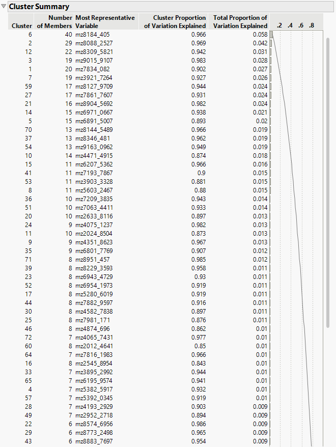

Figure 17.6 Cluster Summary (Partial Report)

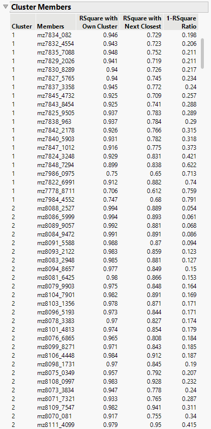

Figure 17.7 Cluster Members (Partial Report)
The Cluster Summary and Cluster Members reports show that the variables are clustered into 72 groups, so there are 72 Cluster Component variables. These 72 variables are also added to the data table as a new column group of formula columns.

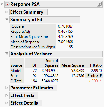

Figure 17.8 Fit Least Squares Report for Model with Cluster Components as Predictors
The Least Squares report shows that the model that uses the 72 Cluster Components as predictors performs reasonably well (p-value < 0.0001) with an adjusted RSquare of 0.467. These values indicate that the predictors provide explanatory power for the response. Reducing 667 variables to 72 components results in some loss of information, but the model remains effective and demonstrates that variable clustering is a valuable technique for dimension reduction in high-dimensional predictive modeling.
