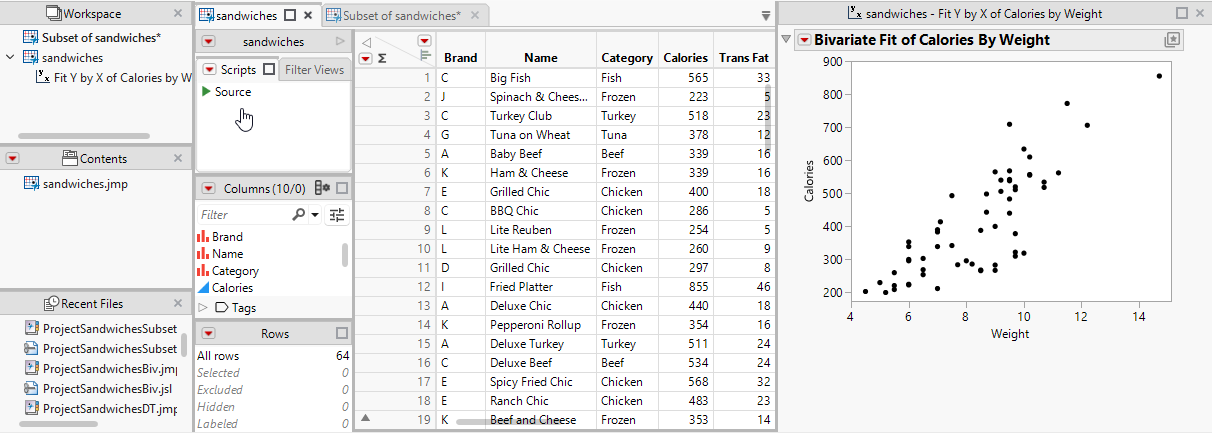

Figure 11.27 Project with Sandwiches Data Imported

Figure 11.28 Fit Y by X (Bivariate) Report Docked at Right

Figure 11.29 Project with Unsaved Subset Table

Notice that the subset table that you did not save has been saved automatically to the project file.
