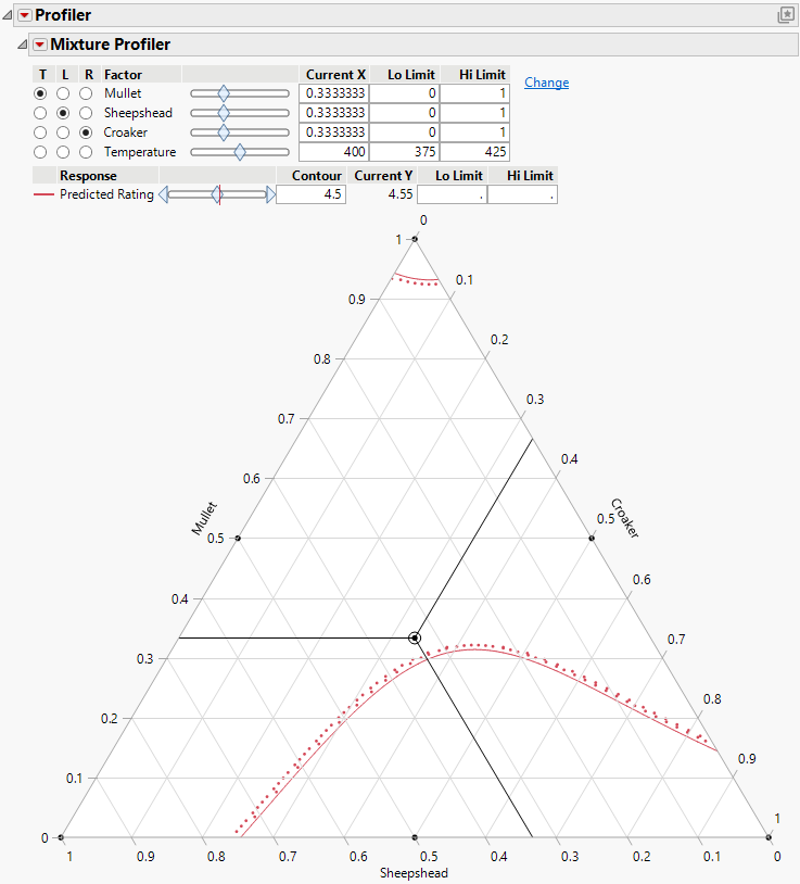

Figure 6.8 Initial Output for Mixture Profiler

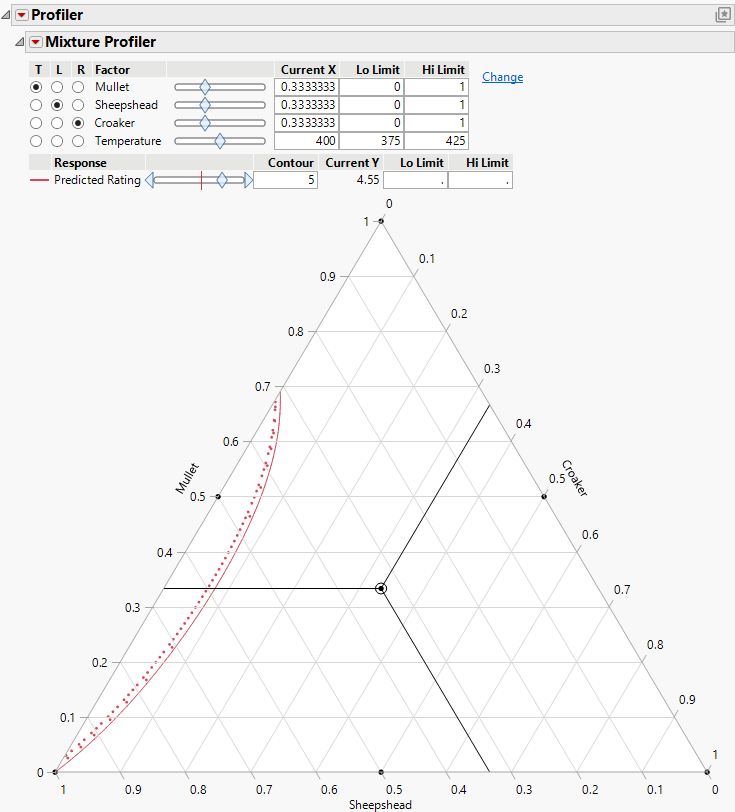

5. The manufacturer wants the rating to be at least 5. Use the slider control for Predicted Rating to move the contour close to 5. Alternatively, you can enter 5 in the Contour edit box to set the contour to 5.
Figure 6.9 Contour That Shows a Predicted Rating of 5
The Up Dots shown along the contour indicate the direction of increasing Predicted Rating.

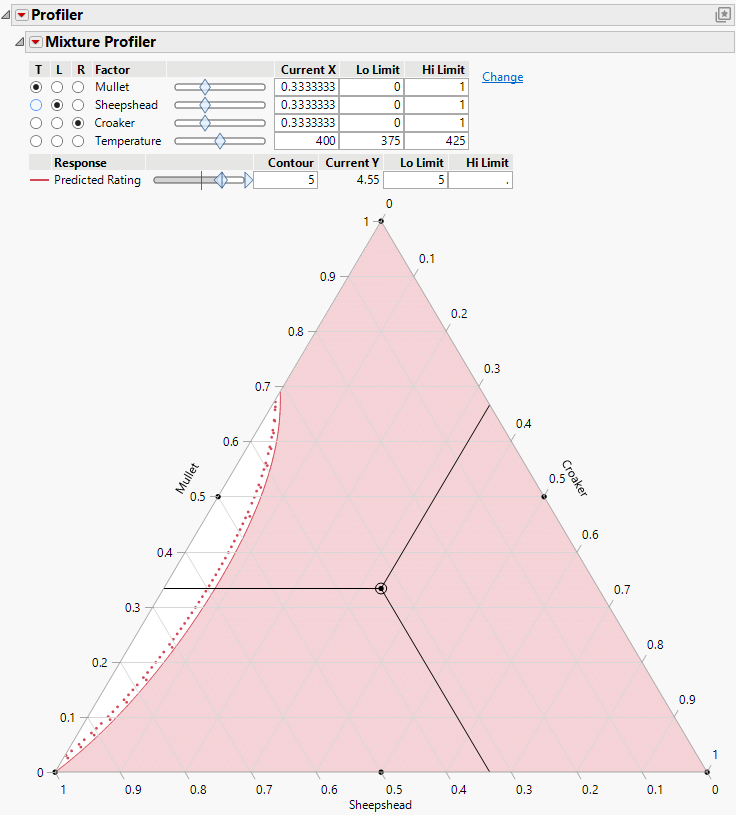

6. Enter 5 in the Lo Limit edit box for the Predicted Rating. The resulting shaded region represents factor combinations that yield a rating less than 5. To produce patties with at least a rating of 5, the manufacturer can set the factors values anywhere in the feasible (unshaded) region. The region has small proportions of Croaker (<10%), mid to low proportions of Mullet (<70%) and mid to high proportions of Sheepshead (>30%). This region is for a baking temperature of 400 degrees.
Figure 6.10 Contour Shading That Shows Predicted Rating of 5 or More.
7. Move the slide control for Temperature to observe how the feasible region changes for different temperature settings.
