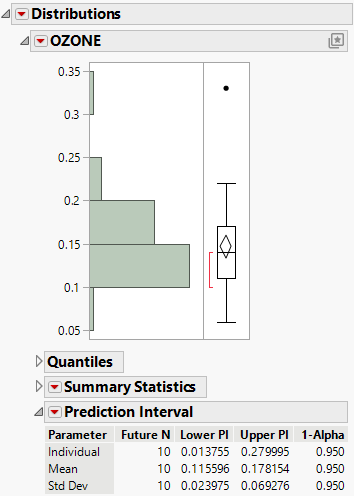

Figure 3.19 Example of a Prediction Interval Report
In this example, you can be 95% confident about the following findings:
• Each of the next 10 observations are likely to fall between 0.013755 and 0.279995.
• The mean of the next 10 observations is likely to fall between 0.115596 and 0.178154.
• The standard deviation of the next 10 observations is likely to fall between 0.023975 and 0.069276.
