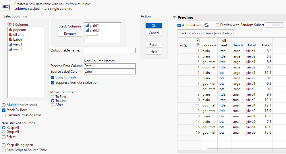

Figure 6.8 Completed Stacked Window
4. Click OK.
In the Preview panel, the Label column represents the Source Label Column that identifies the source of the data. Its values are the column names in the original table from which the stacked values originated.
