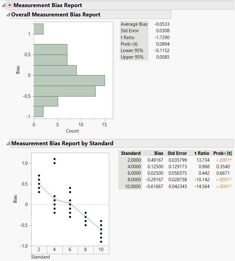

9. Click the Variability Gauge Analysis for Response red triangle and select Gauge Studies > Bias Report.
Figure 6.11 Measurement Bias Report
The bias (Response minus Standard) is calculated for every measurement. The Overall Measurement Bias Report shows a histogram of the bias and a t test to see whether the average bias is equal to 0. You can see that the Average Bias is not zero, it is -0.0533. However, zero is contained within the confidence interval (-0.1152,0.0085), which means that the Average Bias is not significantly different from 0. Using a significance level of 0.05, you can see that the p-value is greater than 0.05, which also shows that the Average Bias is not significantly different from 0.
The Measurement Bias Report by Standard shows average bias values for each part. The bias averages are plotted on the graph along with the actual bias values for every part, so that you can see the spread. In this example, part number 1 (with a standard value of 2) is biased high and parts 4 and 5 (with standard values of 8 and 10) are biased low.

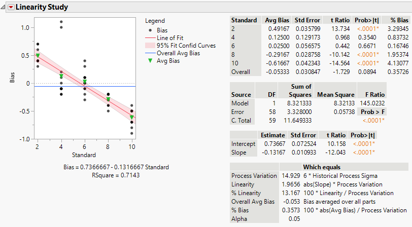

Use the Linearity Study option to determine whether there is a significant relationship between the size of the parts and the operator’s ability to measure them. First, you must specify a historical process sigma.
1. Click the Variability Gauge Analysis for Response red triangle and select Gauge Studies > Edit MSA Metadata.
2. In the Edit MSA Metadata window, enter 2.488105 as the value for the Historical Process Sigma. This is the standard deviation of the response. The Historical Process Sigma is used to calculate the Process Variation.
3. Click OK.
4. Click the Variability Gauge Analysis for Response red triangle and select Gauge Studies > Linearity Study.
Figure 6.12 Linearity Study
Linearity Study
Note the following estimates:
• The slope is -0.131667. This value appears as part of the equation below the graph, and also in the third table.
• The p-value associated with the test on the slope is quite small, <.0001. The t test for the slope is testing whether the bias changes with the standard value.
Because the p-value is small, you can conclude that there is a significant linear relationship between the size of the parts and the operator’s ability to measure them. You can also see this in the graph. If the part or standard value is small, the bias is high, and vice versa.
