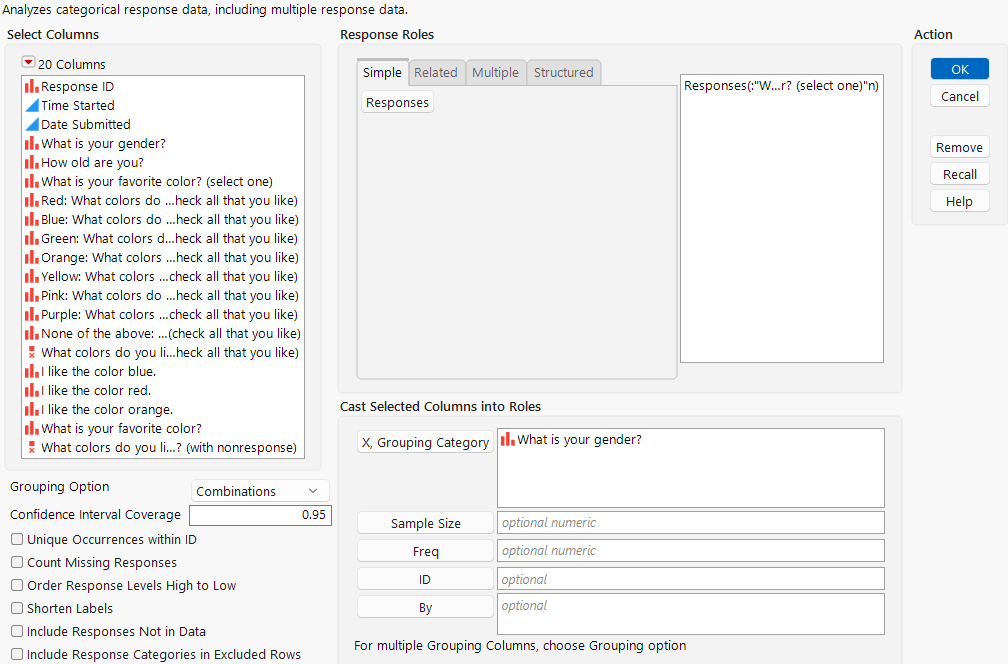

1. Select Help > Sample Data Folder and open Color Preference Survey.jmp.
2. Select Analyze > Consumer Research > Categorical.
3. Select What is your favorite color? (select one) and click Responses.
4. Select What is your gender? and click X, Grouping Category.
Note: If you want to run the single analysis of favorite color by gender, click OK now.
Figure 3.2 Completed Simple Tab in the Categorical Launch Window

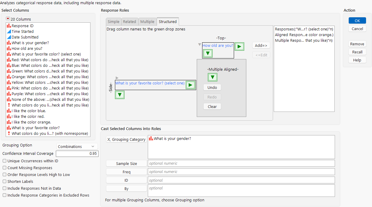

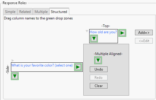

9. Select the Structured tab.
10. Select and drag What is your favorite color? (select one) from the Select Columns list to the Side green arrow. Select and drag How old are you? to the Top green arrow.
Tip: Instead of dragging, you can click a green arrow in the structured tab to add a column for analysis.
Figure 3.3 Structured Tab in Categorical Launch Window
11. Click Add.
The What is your gender? column specified in the X, Grouping Category role does not apply to the structured analysis.
Figure 3.4 Completed Launch Window for Full Example
The three groups of analyses are listed in the panel on the right of the launch window.
12. Click OK.

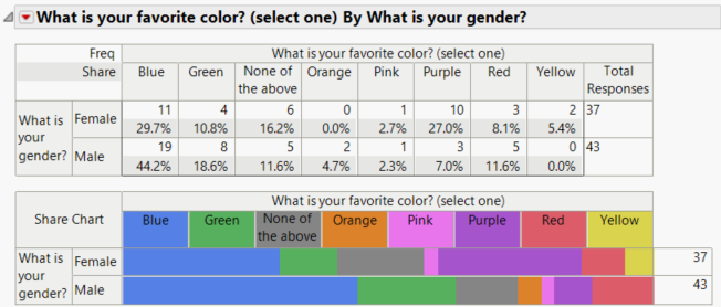

The first section shows the results for the simple response survey question, “What is your favorite color?”, grouped by gender. Each respondent was asked to select one color from the list: Red, Blue, Green, Orange, Yellow, Pink, Purple, or None of the above.
Figure 3.5 Simple Response: Favorite Color by Gender
The analysis shows that blue is the favorite color for all genders. For males, the frequency of the 43 male respondents selecting blue is 19. This corresponds to a share of 44.2% or 19/43. For females, 11 of 37 female respondents (frequency) or 29.7% (share) selected blue.

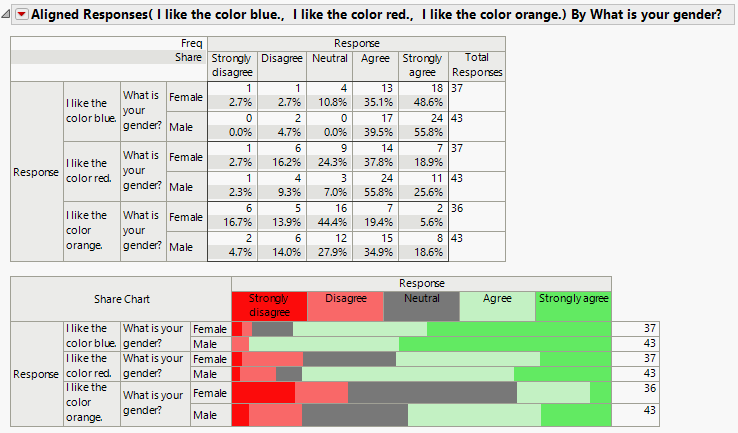

The second section of the report shows the results for three related questions that asked respondents to rank how much they liked a color. The responses to these questions are aligned because the questions used the same rating scale of Strongly agree to Strongly disagree.
Figure 3.6 Aligned Response: Ranking Colors by Gender
The analysis shows that blue is the color with the highest rankings for both males and females. Orange has a high number of neutral results for all genders as compared to red and blue. In this example, the Value Colors column property defines the colors used in the share chart.
Note: If you analyze aligned questions individually using the Simple tab, you get three individual reports containing the same information as the related report. Using the Related tab aligns the reports so that the results are easier to compare to one another.

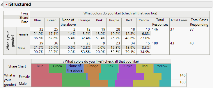

Multiple Tab Report
The third section in the report shows the results from a multiple choice survey question grouped by gender. The question was “What colors do you like? (check all that you like)”. Each possible response was collected in an individual column. If the subject selected a response, there is a value in the corresponding column. Otherwise, the column is empty.
Figure 3.7 Multiple Response: Colors Liked by Gender
From the results, observe that blue and green are highly liked by all genders. Females like pink and purple at higher rates than males.
In a multiple response question, more than one answer is allowed. A case represents a single respondent, and Total Cases is the total number of respondents. In the data, there are 37 female cases and 43 male cases. The Total Cases Responding is the number of cases that selected one or more responses.
The Total Responses column lists the total number of selections made. For females, there were 146 colors selected by the 37 female respondents. For males, there were 180 colors selected by the 43 male respondents. The tabulation includes the number of respondents selecting each color, the share or the percent of the total responses, and the rate or the percent of the total cases.

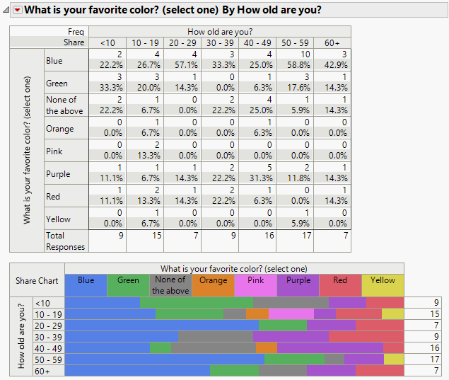

The final section shows the table that is generated from the structured tab, where you set the favorite color question as the response of interest grouped by the age group. In the structured format, the levels of the primary response of interest form the rows of the table and the levels of the grouping variable form the columns.
Figure 3.8 Structured: Favorite Color by Age
The 10 to 19 age group has two respondents with pink as their favorite color. No other age groups have respondents with pink as their favorite color. You can see from the bottom row of the table that the number of respondents in each age group is small. You could gather more data to draw conclusions about the favorite colors across age groups.
