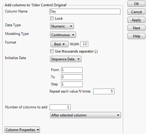

1. Select Help > Sample Data Folder and open Odor Control Original.jmp.
2. Select the first column, Run.
3. Select Cols > New Columns.
4. Next to Column Name, type Day.
5. From the Initialize Data list, select Sequence Data.
6. Enter the following values:
– 1 for From
– 3 for To
– 1 for Step
– 5 for Repeat each value N times
7. Next to Number of columns to add, type 1.
Figure A.11 Completed New Columns Window
8. Click OK.
The Day column is added as the second column in the data table.
