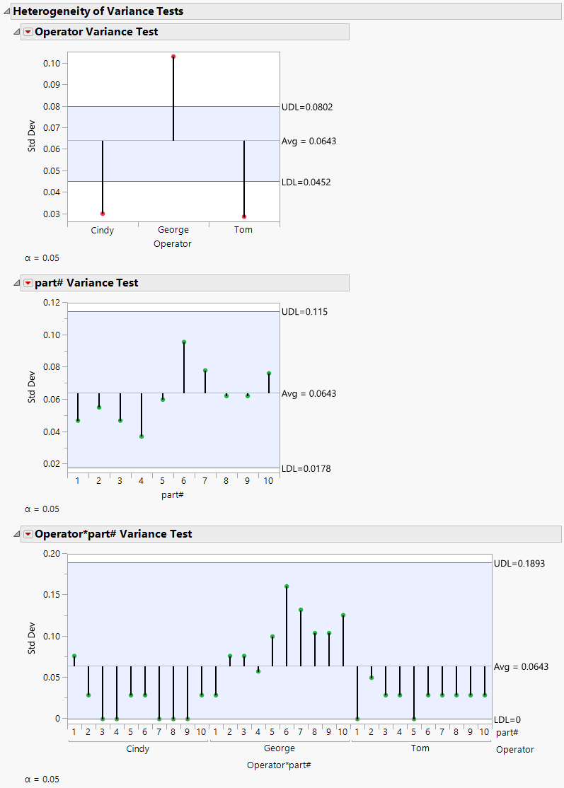

Figure 6.10 Heterogeneity of Variances Tests Report
In the Operator Variance test, all of the levels exceed the decision limits. In the part# Variance test, none of the levels exceed the decision limits. These plots are in terms of standard deviations. From this, you conclude that the operator standard deviations differ from the average corresponding group standard deviation, but the part standard deviations do not. The operators have different variances compared to the other operators, but each part has a similar variance to the other parts.
For the interaction (Operator*part#) Variance test, there are a few combinations that have standard deviations that fall on the decision limits. While most of the Operator*part# combinations have similar variances to the other Operator*part# combinations, you might want to examine the combinations that are near the decision limits.
