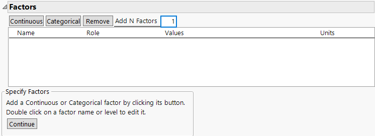

Figure 8.6 Factors
Factors
The factors section contains the following buttons.
Continuous
Enters the number of continuous factors specified in Add N Factors.
Categorical
Enters the number of nominal factors specified in Add N Factors.
Remove
Removes the selected factors.
Add N Factors
Adds multiple factors of a given type. Enter the number of factors to add and click Continuous or Categorical. Repeat Add N Factors to add multiple factors of different types.
Tip: When you have completed your Factors panel, select Save Factors from the red triangle menu. This saves the factor names and values in a data table that you can later reload. See Definitive Screening Design Options.
